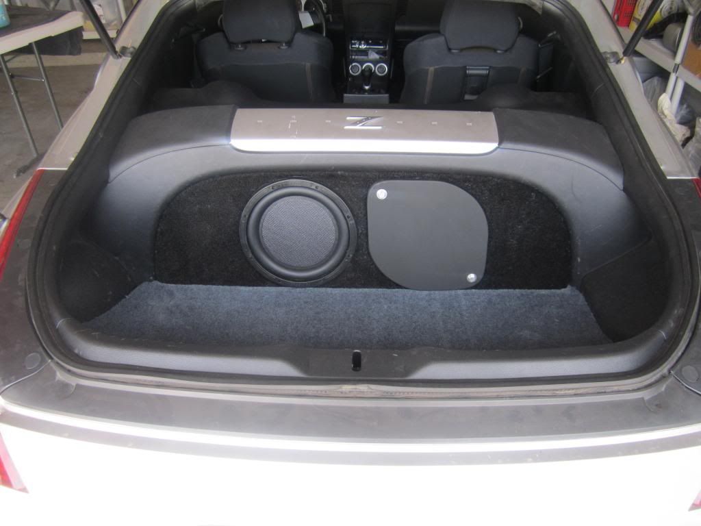

You can definitely put together a decent system for under $1000. My suggestion would be to invest in a good set of component speakers($150-$300), a good 5 channel amp($200-$350), and a Zenclosures.com box($150) for that single 10" sub. A decent head unit can be had for $300-$400. With a set up like that you won't even need the rear speakers.
Using the 5 channel amp allows you to run everything without needing multiple amps. This is the set up I am running but using two Alpine type R 10's. Honestly, those two 10's are a bit much. That single JL should do you fine.

Unless you want a navi/touchscreen headunit you don't need to spend that much. Some of the best HUs around are much closer to 200.
Just stick with one sub IMO. Theres not really enough airspace in an under-strut box for 2 unless they are shallow or designed for home audio. One hits hard enough as well.
Lugo has the right idea in my mind with a single amp. More just makes things more complicated to install.
300 Front speakers: http://www.sonicelectronix.com/item_...BL-MS-62C.html
200 Head unit: http://www.crutchfield.com/p_020CZ70...ion-CZ702.html
130 Box for sub: http://www.ebay.com/itm/ZEnclosures-350Z-Subwoofer-Enclosure-Sub-Box-1-10-NEW-/300500682236?pt=US_Speaker_Sub_Enclosures&hash=item45f73c85fc225 3 channel amp (forget about your rears being amped, pointless): http://www.ebay.com/itm/Massive-Audio-Nx3-AMP-3CH-120w-X-2-800w-X-1-Nano-Block-/121101845452?pt=Car_Amplifiers&hash=item1c323b83cc
Along with any 4awg amp kit and other misc things brings it up to around a grand! forget about your rears completely or hook up a random pair of coax you get for 50 bucks to the headunit power.
Ill sell you some zenclosures door spacers for 10 plus shipping =]

At this point, you almost have to buy 2 subs. Your amp will put out 500 watts at pretty much any impedance it seems, but 500 will certainly trash your single sub. Get two, run them in parallel so they get 250 each or order a new beefier single sub (my choice) that can handle 500 watts.

Heres the spacers I was talking about: http://www.zenclosures.com/Nissan-In...infinitisp.htm
What you might be thinking of is door pods, and those are a bit more complicated and a lot more expensive. These just set the speaker out far enough so it doesn't hit the glass when your window is rolled down. Your OEM speaker set has these built in, so you can do some really ghetto salvaging if you want, or get a new set.
If you just want to make do here's what you can do. Forget about amping your rear speakers (for now!). Connect two of your 300/4 channels to your current subwoofer (this is called Bridging, where you connect the positive of channel 3 to the positive pole on the sub and the negative of channel 4 to the negative on the sub) then connect your other two channels (unbridged) to your new front speakers.
How much do you want to spend on your front speakers? If you give me a sort of price range I will have a easier time getting you a good recommendation.
Also, rears are coaxial, this means that its all sort of one piece. The fronts do better with what are called Component speakers. These have tweeters seperated from the mids (so you can put them in stock locations) as well as a separate crossover (which sends the correct signals to the diff. speakers). Component speakers are almost necessary for the front, and are also generally considered higher quality than their coaxial counterparts because of the higher quality separate crossover.

Also, if you're still unsure about 1 or two subs, you can always do what I did. Order a double box and build a cover for the other side youre not using. This will require me to get a bit creative in filling the two mounting holes when I do go to 2 subs, but for now it works really well and gives me the freedom to do what I want.
