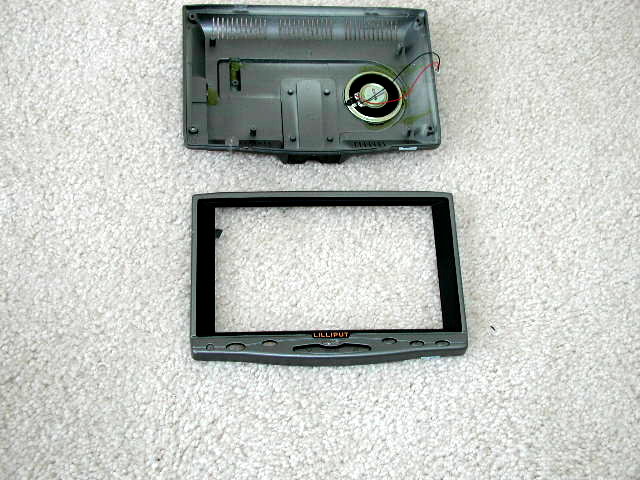

Herer is the Lilliput TouchScreen case opened up. I took out the LCD screen.

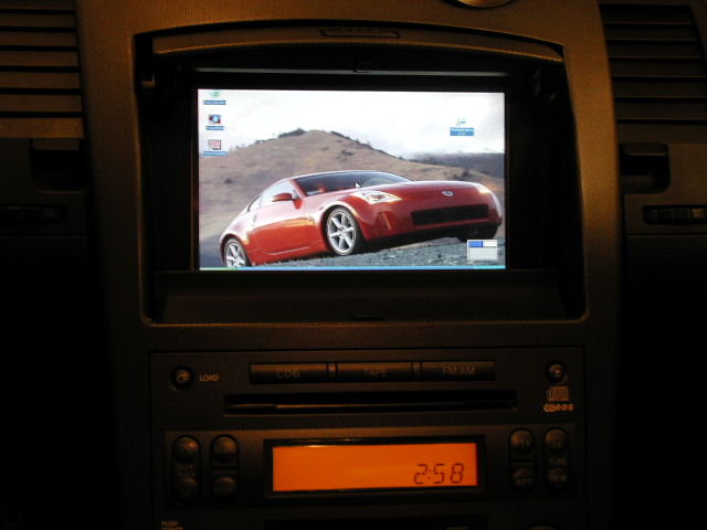

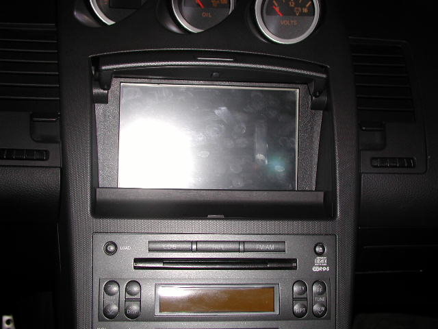

here it is in the car

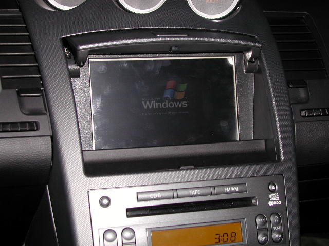

here is the start up screen

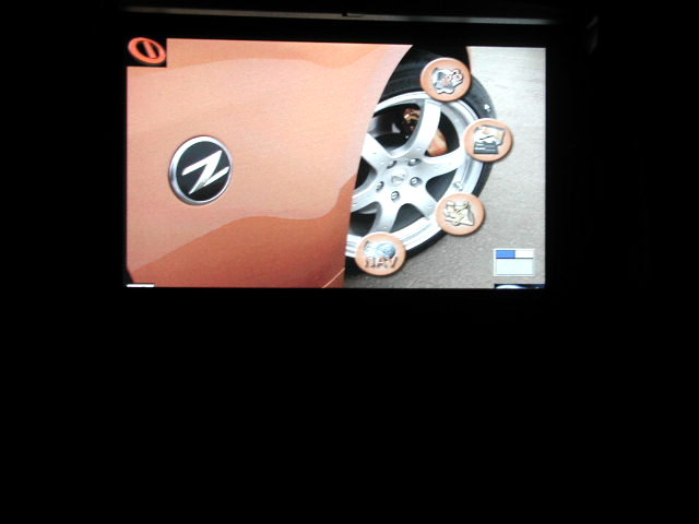

here is the interface at work, 1st is the mp3's 2nd is the dvd's/cd's 3rd is the playlists 4th is the nav

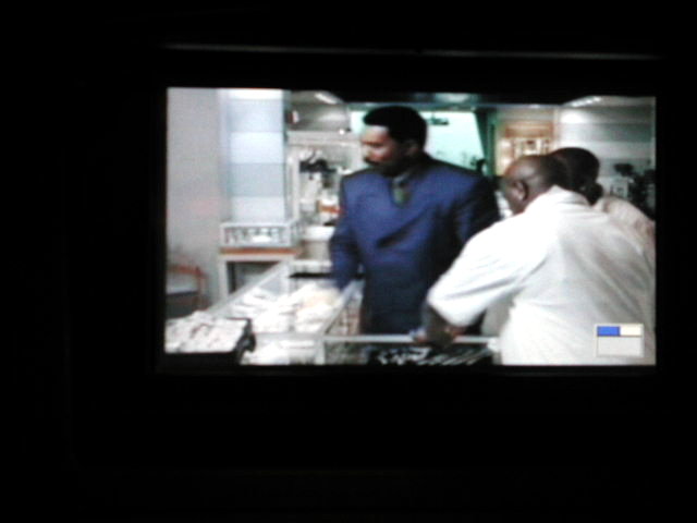

big tymers vid.

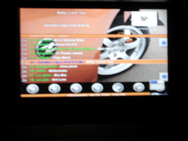

This is how easy it is to control the mp3's. Sorry it’s blurry. If any one wants to buy the touch screen let me know. $310 shipped.

Old Jan 28, 2004 | 07:26 PM
z327's Avatar
z327
Posts: 246
From: Sachse, Texas
Looks good....but get some windex

Old Jan 29, 2004 | 02:01 PM
ares's Avatar
ares
Veteran
Posts: 10,816
From: ATL
its more or less unavoidable when your talking about a touch screen.

Old Jan 30, 2004 | 12:04 PM
CopperZ's Avatar
CopperZ
Posts: 343
From: IL
Originally posted by Grommit
What are the specs of that screen? What resolution does it support? And what inputs does it have?
I am very interested in buying it. Is the picture sharp? When you play DVD's on it, does the picture blur between frames? does the picture look grainy? Can you post a higher quality pic of the screen???
LCD screen size: 7 inches digital (15.4 x 9.2 cm)
Ratio: 16:9 wide TFT screen, high resolution: resolution: 2,400 x 480 = 1,152,000 pixels
Support computer display resolution up to 1024 x 768
Multi Video system: PAL/NTSC
VGA and 2 composite Video inputs plus 1 Audio input
Touchscreen display (USB interface)
Credit card size IR remote control
Full function OSD control (Multi-language)
Audio output: Speaker built-in & earphone jack
Video input signal: 1.0Vp-p, composite video
No radiation (better for eyes protection)
Compact slim panel: 18.7 x 12.5 x 3.3 cm only
Computer display/S-video/DVD/VCD/Security system/Navigation system compatible, (Rear view camera connectible)
Mount type: Dash board
Power input: DC 12V, Power consumption: 9W
Jacks
AC in
Head phone
USB port
Accessories
1. 1 pc VGA / USB 2-in-1cable
2. 1 pc A/V cable
3. Remote control with battery
4. Touch pen
5. Switching AC adapter
6. Car 12V adapter
7. User Manual
8. Installation CD (touch screen) with drivers for DOS, windows 95, 98, NT, 2000, ME, and XP
The picture is very sharp, it looks a lot better then my laptop screen. I did not have a chance to play dvd’s on it because my laptop does not support dvd’s. I only played vcd movies and there was not freezing up or anything. Movies look whole lot better then they do on the laptop screen.
The only problem that I noticed is that it flickers when I first start it. This is hard to see and you can only see it when you look really hard at the screen. But then the flickering goes away. I think it just needs to worm up a bit because it did not flicker when it was in my house. And its 2 degrees outside right now so im guessing that’s why.
The major problem that I found is that when it’s really sunny outside its a little hard to see the screen. But then again I have no tints and that happens to every lcd screen. I will take some pic’s when I get my car back.

Old Jan 30, 2004 | 03:20 PM
MannishBoy's Avatar
MannishBoy
Posts: 5,282
From: Nashville
I read a lot of posts on this screen several weeks ago over at mp3car.com, and all the defects have me scared to death of the thing. I wish I could get over my nervousness, and I'd get one
Old Jan 30, 2004 | 03:58 PM
CopperZ's Avatar
CopperZ
Posts: 343
From: IL
The top is not cut off. The bottom seems like it is, only on the pictures though because that plastic piece is in the way of the camera and I was holding the camera low.
The controls are under that same plastic piece and I control it with the remote. I did not even have to drill a hole for the signal to go thru because there is a little hole in there already for the door lock.
MannishBoy, I read the carMp3 reports as well, I heard nothing but good things about it. there is only a 3% defective rate on lilliput screen’s. Please let me know where you saw the reports.
