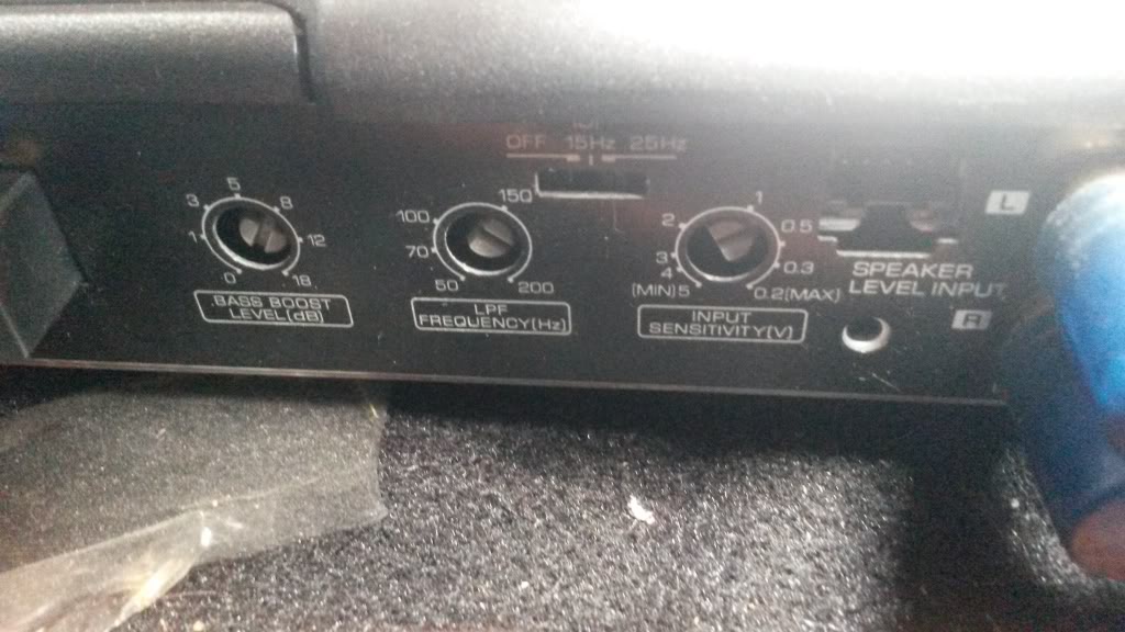

Old Feb 26, 2014 | 01:50 PM
Whiteazn2's Avatar
Whiteazn2
Joined: Jan 2011
Posts: 221
From: Las vegas
It's not up to high

Old Feb 26, 2014 | 01:54 PM
92K1500's Avatar
92K1500
Joined: Jan 2010
Posts: 1,458
Likes: 15
From: Sapulpa, OK
Uh, according to Kenwood it's a 300W amp.
http://my.kenwood.com/Car_Entertainm...iers/KAC-8103D
Rated Power Output [14.4V]
• 300W x 1 at 4ohms [20-200kHz 0.5% THD]
Old Feb 26, 2014 | 01:55 PM
Whiteazn2's Avatar
Whiteazn2
Joined: Jan 2011
Posts: 221
From: Las vegas
http:// Name:  20140226_144324_zpse1ac9116.jpg

Old Feb 26, 2014 | 02:16 PM
92K1500's Avatar
92K1500
Joined: Jan 2010
Posts: 1,458
Likes: 15
From: Sapulpa, OK
That picture doesn't tell me anything. I don't know where the **** is when it's rotated all the way counter clockwise and I don't know the line voltage on your preout.
Physical position of the **** means nothing. Output voltage tells you where to set it.
Also, max power means nothing to anybody. RMS is the only thing to look at.
