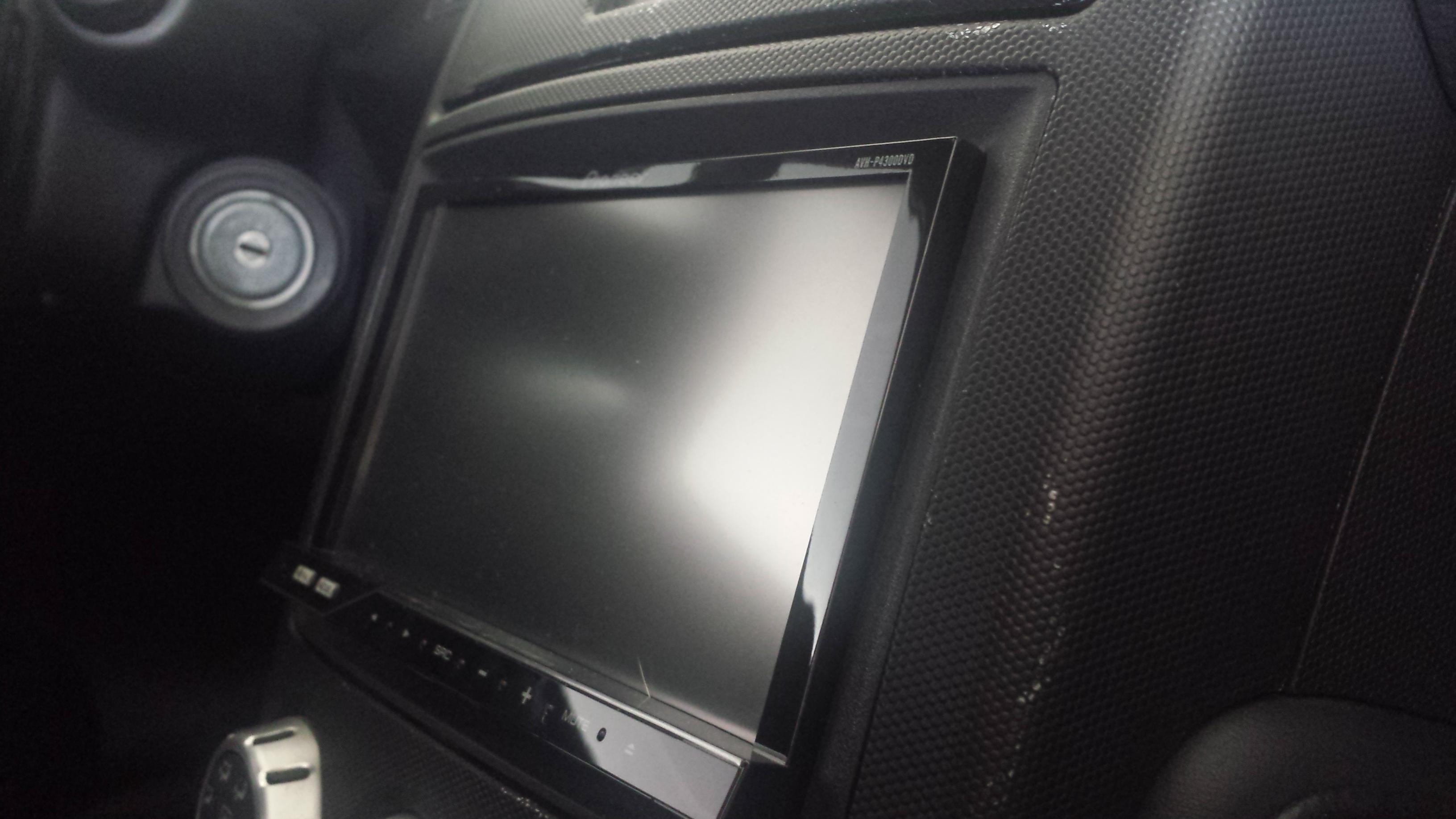

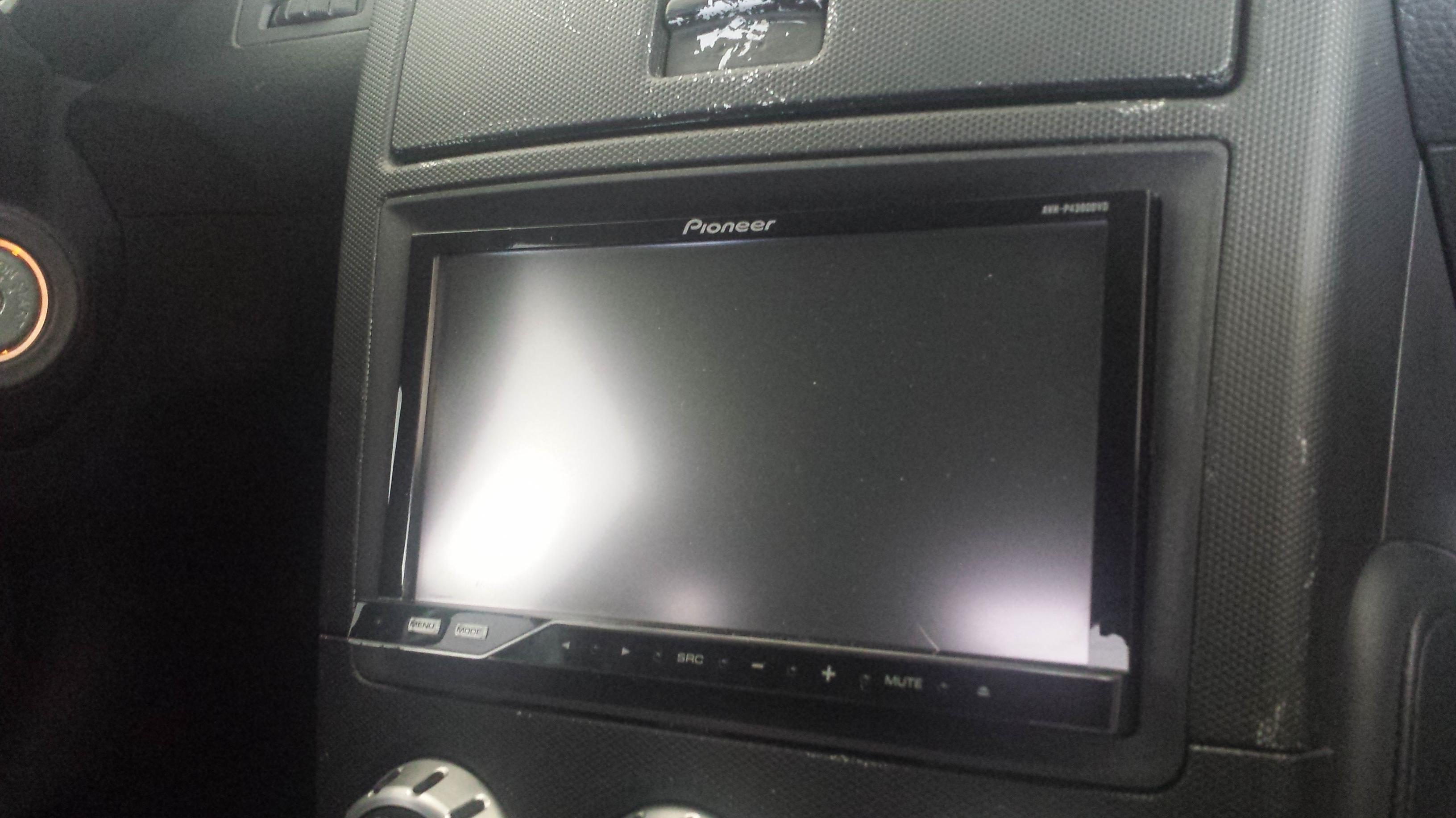

Attached Thumbnails Better stereo mount than Metra?-20140624_111654.jpg   Better stereo mount than Metra?-20140624_111723.jpg

I'm using factory brackets that I picked up from ebay. There are only 4 holes in the brackets and they only line up with 4 holes in the stereo. I will double check that this weekend, but I'm pretty sure. I checked it and my brother double checked it.
What mount kit did you use? That looks WAY better than mine.

The reason why it does not sit flush is because you picked up an 06 or newer dash kit. 04's dont curve at the corners on the bottom. They are squared all around.
06 dash kit notice how the bracket curves at the corner?
04 dash is squared all around
this is what i got:
http://www.walmart.com/ip/Scosche-20...N-Kit/23841940
you can order them from walmart and pick up in store.
The only problem I had with the kit is that on my pioneer dash (The same one travlee posted). The screen, when you press the eject button, slides up and out. When mine would slide up, it would hit the bracket. IDK if your pioneer is the same. But if so, you will have to find a way to mount it farther out like travs picture.
