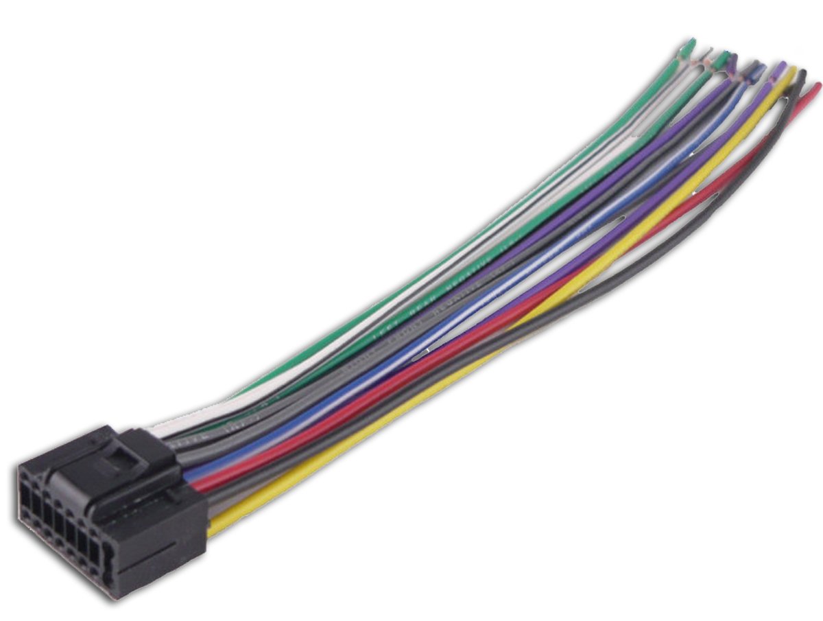

Hi guys, i have a custom stereo with this sort of ISO connection on the back.
But my Z only has this sort of connection (ISO).
Are there any adapters available to connect it to my Z?

Hi, thansk for the answer i got this one already for it.
But i guess i need an adapter for it now?
If i have the bose system i need the PAC right?

Hi, i did get this with the stereo, i guess it will work?

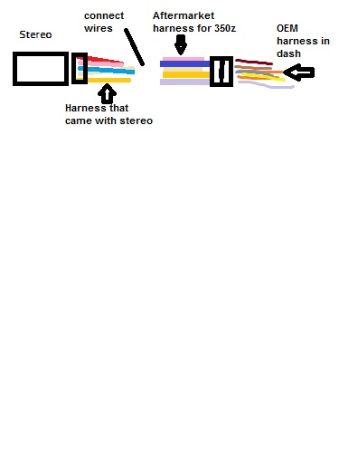

I have that, didnt you see my images?
I dont think you guys understand me correct, i have a stereo like this
My bose system will not work properly without the PAC right? so i connected the PACK to these connections
Then i plugged these two wires into the PAC.
And now i need to connect this one to my new head units iso right?
To this port on my new headunit,
Or im a totaly wrong?

The PAC unit you have is not required. It was designed to feed aftermarket external amps from the factory radio...
"DESCRIPTION
Vehicle specific harness plugs into the vehicle's wiring and offers a 4 channel RCA audio output for adding aftermarket amplification. Provides full range audio output 20-20,000Hz. Audio output level is controlled by the volume of the factory radio."
Since you don't have the factory radio now you need to follow MatthewBouchard diagram. Instead of that PAC use this:
Amazon.com: Metra 70-7551 Amplifier Integration Harness 995-2005 Nissan and Infiniti: Car Electronics Amazon.com: Metra 70-7551 Amplifier Integration Harness 995-2005 Nissan and Infiniti: Car Electronics
Hopefully your aftermarket radio has 4V RCA preouts because that seems to be the requirement to drive the BOSE amp properly.
Most people here (including me) will recommended you trash all the BOSE junk and go full aftermarket. Granted that means new speakers and a new amp but it will sound 100X better. The BOSE system is truly terrible, thus any advantage gained with the aftermarket radio is lost.

Use what you have, this:
http://cimg1.ibsrv.net/gimg/my350z.c...748e1adaf7.png
Once again MatthewBouchard diagram is correct:
Aftermarket radio > your harness (not the PAC) > splice connections > adapter I linked to above > factory wiring
https://my350z.com/forum/attachments...ll-wireeee.jpg
I think the step you are not understanding is in Matt diagram's where is says "connect wires" that is a manual process - you have to physically cut the plastic off the wires to exposure the cooper inside then splice them to the other adapter. There will be NO adapter that connects the factory wiring to your new radio directly. Instead you need two adapters: one for the aftermarket radio (you have that part already) and the one you need to buy that connects to the factory wiring. The work required is to cut and splice these two together properly.
Keep in mind for any radio to work you need multiple connections, these are normally the colors listed here: http://knowledge.sonicelectronix.com...lor-standards/
In your case the speaker wiring is not required instead you can use the white and red RCA jacks / plugs on your radio and the adapter I linked.
If this is too confusing PLEASE find an specialists store to do the work for you! Doing this wrong can damage your car and/or your radio. Sometimes its worth the money to pay a professional to make it work correctly.

Thanks and i understand perfectly now , i bought one of them on ebay now.
