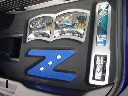

Scott Webb's Avatar
Scott Webb
Posts: 525
Likes: 14
From: Huntington Beach, CA
I'm running a Farad cap with the stock battery in mine. Haven't noticed any dimming of the lights.
Very nice. How much did you pay for that whole set up (if you dont mind me asking)
