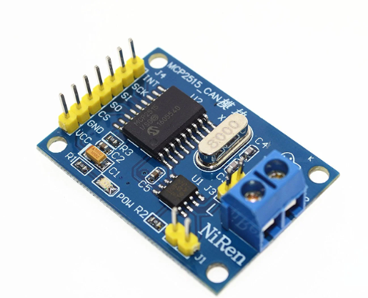

So i bought this module called MCP2515 (pic attached), and connected it to my arduino circuit eventho still not so sure how to intercept the car messages and extract the data.
What i intend to display on my screens are the oil pressure, battery voltage, and all data that is displayed on the first digital screen. I've done a lot of research and some sources are saying that i can get them from the CAN network, and other sources are saying through the TX/RX system.

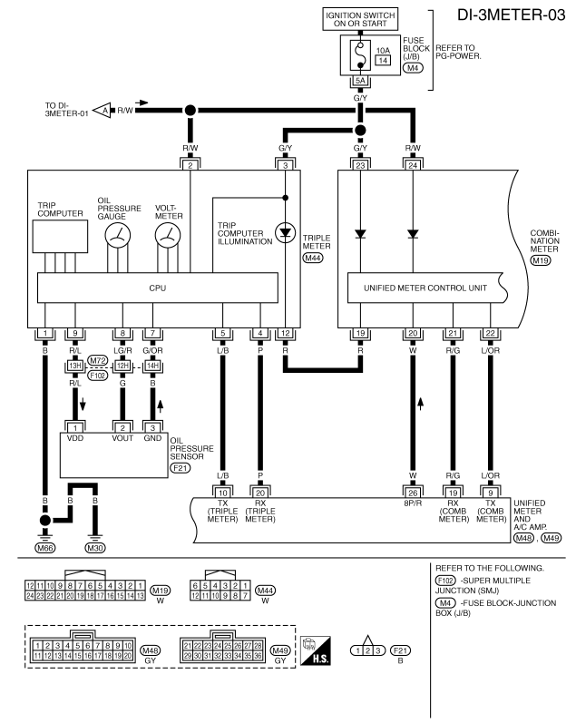

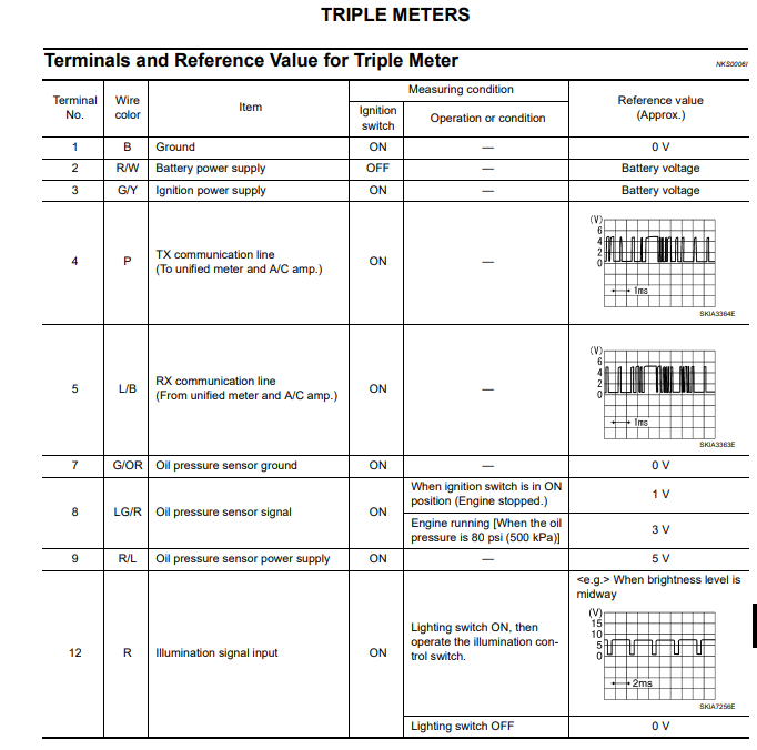

I was digging through the manual and i found this:
And i see that what you said was right, the oil pressure sensor and battery voltage don't go through the CAN system.
So now my focus would be how to find these wires responsible for the sensor signals (as i said im new to all that). I was trying to mess around with the ac amp and ended up burning a couple fuses and a relay

If you have the funds and want to immerse yourself further into CAN I would highly reccomend purchasing the HP Academy CAN Course - I suspect this will help you quite a bit.
as you put it - ‘intercepting’ the CAN messages will be pretty straight forward. You will splice a CAN high and CAN low off the OEM CAN Bus and connect them to your module. I dont know how that module works to read and display the CAN Bus messages but its going to look like a very long list of hexi-decimal and binary numbers with no particular logical pattern.
This is where my knowledge base gets thin and I’m still learning how to find/read the CAN Bus messaging and I dont have a tool / computer program to do this with (yet).
Oil pressure is fed through pins 7(ground) / pin 8(oil pressure 0-5v signal) / pin 9 (5volt supply voltage) and this will be pretty straight forward. I suspect youll take the 0-5v signal and interpolate it to 0-150psi of pressure through your aduino programing.
I dont know how battery volt is fed into the triple meter but maybe you could simply back-pin the M44 connector pins and see if it is a straight 1:1 feed? I wish there was more documentation on how the TX/RX lines function.

I'm back with more questions
So i believe i got the idea of how to connect my circuit to the oil pressure sensor and battery voltage sensor.
But... still can't figure out which connectors are mentioned in the diagram above.
If you have any idea, can you point me to this connector and where it is placed in the car:

You want connector M44 which is a white connector and pins 7-8-9 are your oil pressure sensor wires. Connector M44 connects to the left side (drivers side) of the triple gauge.
Do you have a volt meter?
You can turn the ignition on and look for the wire that has a steady 5volts on it - this is the sensor power supply (pin 9)
Then use the resistance function to find the ground … hood one probe to bare metal on the car and go two pins over and see which has continuity this is the sensor ground (pin 7)
then the middle pin between those two and you should get a very small voltage (like .5volts) and this is the sensor 0v-5v output.
Let me know if you / how you find the battery voltage signal … could be as easy as pin 2 or pin 3?
Let me know if you need further help
