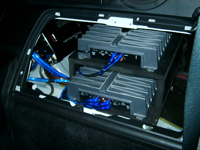

This is the only thing you wanna put in there.
I have heard from so many people that subs sound like crap in the OEM compartment.
Do some searches, some folks have tried it, you might wanna PM them though. But overall, I heard they don't sound very well as opposed to a box in the strut bar, tire well, ect.
Gl on whatever you do. Post pics, ect.
