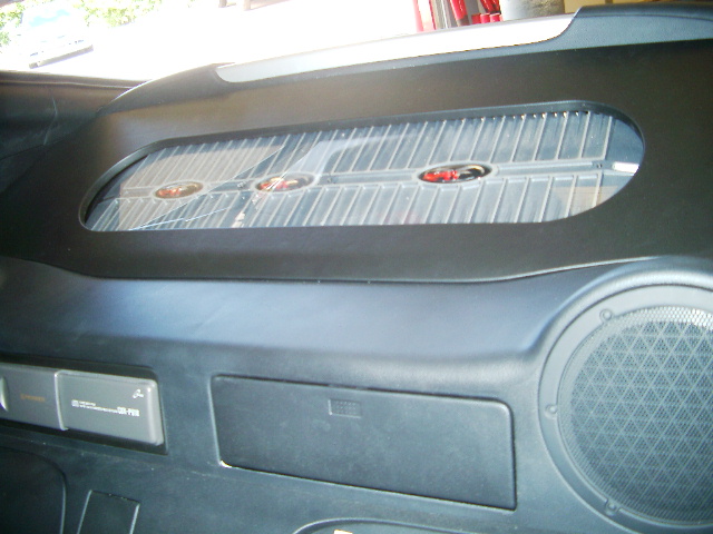

Heres mine, fairly large size for a 6-disc. A little dusty and blurry, and the amp rack has been removed and amps placed in the OEM sub compartment.
Attached Thumbnails for people who added an aftermaket cd changer-imgp1340.jpg

thanks guys for the responses..............i guess 12 disc would be too big
