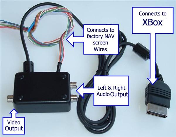

Generator I saw a picture of the NAVBox on your other thread. I labeled the picture. Are my assumptions correct?
Also you mentioned a switch. Is the switch a part of the NAVBox? If so, do you have a picture of it and can it be replaced with any switch (wanted to pickup an extra seat warmer button).
That photo is a prototype photo. The unit is in a different form now, but functionally still the same.
The switch is any toggle swich. A small toggle switch is included. If you see the MPG video I have posted on the Murano website it shows where I put a small switch to toggle back and forth. However in my setup I use a tiny pushbutton switch. I can do that because I also have the NONAG installed as well. The no nag inteface is not necassary but if you do have it it does the following:
1. It commands the NAVBox to blank the screen before the nag screen shows up and then bypasses it.
2. Performs "soft" switching of the NAV screen. You could use a small push button switch to change modes instead of a toggle switch. Everytime you turn the car on the screen will default back to NAV mode. That cant happen when you are using a regular toggle switch.

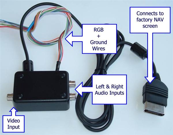

Originally posted by generator
The picture for the mostpart is correct except the RCA conections are actually outputs. This is where the audio comes out to go to the head unit and the extra compostive video comes out for feeding additional headrest monitors.

Where does the Audio Out attach to on the Z/G head unit? Neither cars have AUX inputs. Does it have a built in FM modulator or SAT interface? Will it work with video signals from other video sources?

Rbagget:
Thank you for updating the photo.
There are no "Z" owners I know of yet that have done it, but I am getting a lot of e-mail regarding it. I think there is just a lot of folks scared to take the plunge. Thats OK. I expected that. Nobody was more scared than me when I first took snips to my NAV harness. Once one "Z" owner does it I am sure others will follow. If there are any "Z" owners in the NYC area I will even help with the install at no cost.
KPierson:
How the audio gets into the head unit is strictly up to the end user. Most folks would prefer to use the PAC inteface (www.pac-audio.com) to use the SAT inputs. You could use any RF unit or in the case of the FX you could use existing aux inputs. This kit can basically be used on any RGBS nav system. The audio possibillities change with each vehicle.
I have no immediate plans to offer additional inputs for other video signals. I am trying to keep this simple and cost effective. The way I see it, the Xbox does everything so how often would you use another input and is it worth the extra cost?
