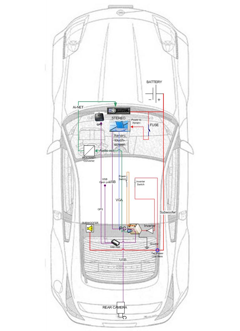

here are the schematics i had drafted before i started building my pc ... (just in case anyone was interested)
Attached Thumbnails Custom CarPC Installed! DVD/Nav/Music/Internet/Phonecontrol-car-pc-wiring-diagram.jpg

So how does it power up/down? Does it have to restart everytime you start your car? I know the answer is too complicated to list.
Old Jan 9, 2005 | 11:24 PM
desiZ's Avatar
desiZ
Posts: 1,494
From: --- Kalifornia ---
there is a low voltage regulator circuit that prevents restarting on enging "crank". but i wanted the ability to totally shut it off if necessary, that explains the little kill switch in the ashtray...

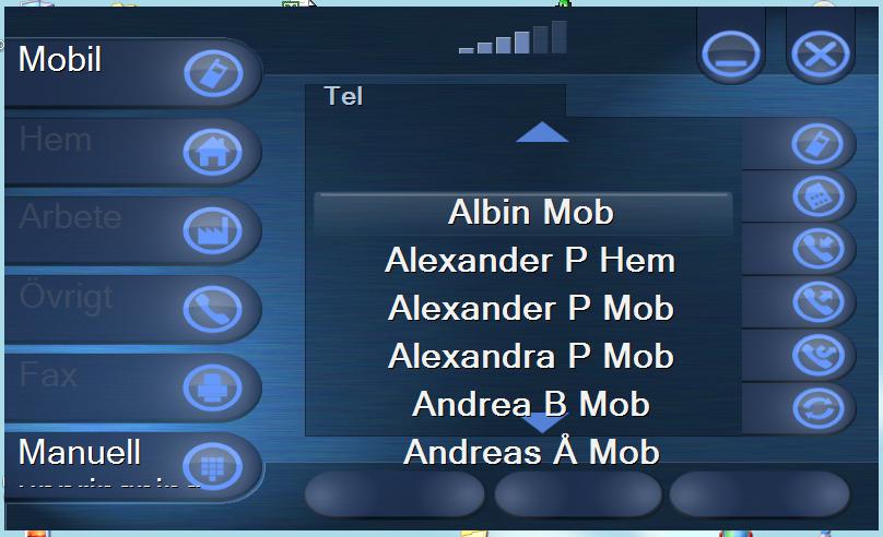

here's a screenshot of phone-control ...
Attached Thumbnails Custom CarPC Installed! DVD/Nav/Music/Internet/Phonecontrol-phonectrl-running.jpg
