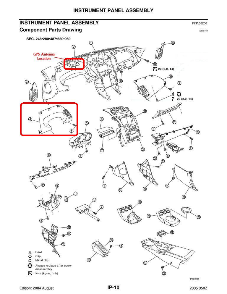

where is the GPS antenna location?
See attached.

thank you im gonna try to find that tomorrow if i get a chance to do the install
