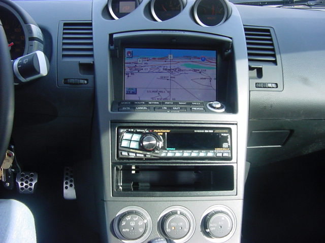

Finally got around to putting a system in my Z. I would like to thank InternetABYSS and SkiDaZZle for some great post on overcoming the nav voice issue.
Components install so far:
Alpine 7894
Metra headunit kit
Alpine TUA-T020XM Satellite radio tuner
Terk TRK-SR2 antenna
JL Audio XR650-CS Evolution Separates (front in stock locations)
Keeping stock speakers in the rear
Kicker 02KX5503 Amp
Lots of Dynomat
Eclipse 3" speaker for Nav voice

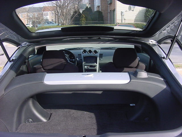

Next Tues the 21st:
Two JL Audio 10IB4 Subs (freeair)
The subs are being mounted in the stock locations behind the driver and passenger seats. My installer found out that the storage compartment behind the passenger is removable and is identical to the sub compartment behind the driver. All I had to order (from Courtesy Parts) was a two grill covers and 1 extra sub mounting bracket. All the holes are already their for the additional bracket. I will attempt to post a few pictures of the install so far:

The sound just with the amp, JL seperates and headunit is incredible! I will post more pictures and give a full review of how the subs and completed system sound next Tuesday.

First off, thanks for posting the pics. Please keep posting them!
Now on to my question.
I ordered a Z and don't have it yet but I am planning the stereo upgrade. I really like the look of the metra head unit you have (that is the black plastic "radio box adapter" right?)
Do you know if Metra has a box to hold a 1.5 DIN or 2 DIN stereo instead of the 1 DIN like you selected? (1 DIN = normal height or car radio) . If so there are a few 1.5 and 2 DIN stereo that have good power and features that I would like to consider.
Also, where is there room for an external AMP in the Z Dash area? I am trying to decide between an easy install (buying a stereo with decent power built in) and a more painfull install (seperate amp) but more power/quality.
I would like to stick with the stock wiring harness as much as possible to minimize install time and impact on the car. On most cars I have owned I just upgrade the stereo unit and speakers and that is "good enough" but with a convertible and odd speaker placement in the z I might need more power than the typical 25W RMS built in amp.

I think dczoner hit the answers to your questions about the metra and amp install. The metra might be able to be configured a little differently because my installer asked me if I wanted the storage pocket. I could ask him and let you know if you would like. I have seen some really nice custom kits on this forum. I couldn't find the post but someone recently made a silver kit with and amber z on it which looked awesome! It all depends on how much $$ you want to spend. I mounted the amp behind the drivers seat in the sub location.

I've always felt amp installs under the seat were nice, if you go for less power, smaller type amps which I did. I have an MTX amp under each seat, so my sub location and storage space is still free. I have a sub in the rear in a hatch box, just waiting to figure out a more permanent home for it.
If you get a chance to ask your installer some of these questions that would be cool.
Now that you mention it, having a little cubby up front might be handy though.

Talked to my installer today. There are a bunch of ways to configure the Metra kit and you can set it up for a double din. 1 1/2 din is not posible, you would have to get something custom made. Hope that helps!
