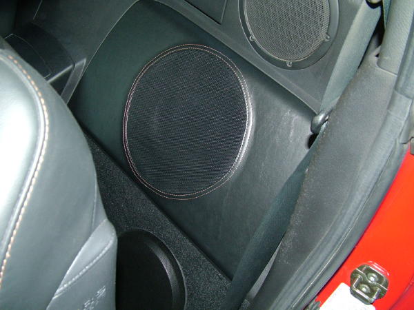

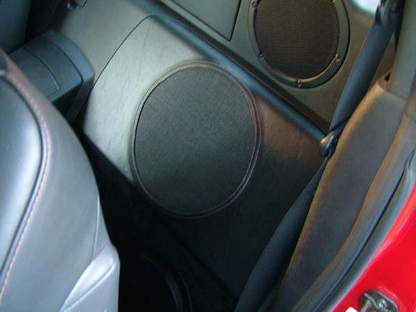

pics for anyone that is interested, the final install looks real clean and sounds great. i even found thread to match the stock stiching on the seats to bring everything together. wrapping the plastic panel eliminated the little rattle that i had due to the fact that the cover now fits reel snug in place.
i would recomend this process to anyone interested in good quality sound while keeping the stock location, if you are interested in winning db competions this is not for you!
final outcome= looks good, sounds good, rattle free, it works for me
That looks real nice. I have a Roadster and definitely will be doing this.
