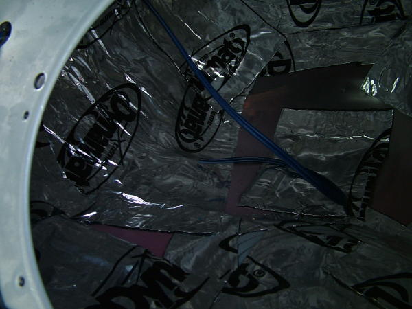

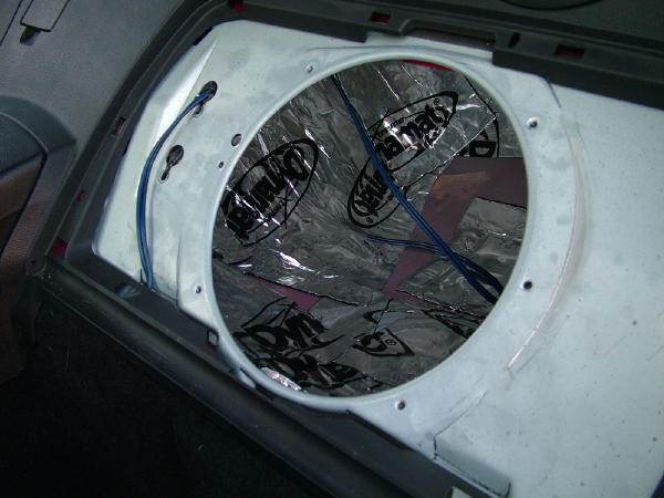

if you dyno mat the area behind the stock sub completely seeling it off, building false walls and basically building a box out of dyno mat you can put a jl10w6v2 in the stock location that will soud good. put dyno mat around the ring the bose sub attached to and the jl sub will drop in using the same mounting space. the only thing you will have to do is modify the cover to fit over the new sub.
i have done this in my own car and it sounds great, not perfect, but does the job very well keeping a stealth look and sounding good.
Attached Thumbnails Subbox in factory location-sub-1.jpg   Subbox in factory location-sub5.jpg   Subbox in factory location-sub4.jpg   Subbox in factory location-sub3.jpg   Subbox in factory location-sub2.jpg
