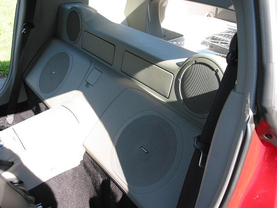

Installed 2 Fosgate 10" HE2, Punch700s, Punch200XI, (2) 6.5 Punch HPC for behind the head, here are some pics of during and the finished product, i hope you like:[IMG]c:\audio\Audio_install-1.jpg[/IMG]

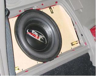

THE CUSTOM MADE BOX

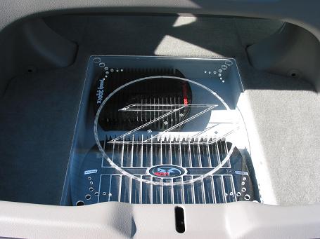

THE AMP RACK W/ THE "Z" EMBLEM ENGRAVED

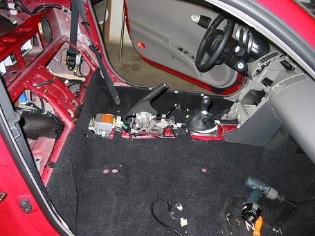

MY WHOLE CAR TORN APART, I WAS SAD TO SEE IT IN PIECES

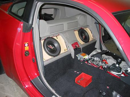

THE BOXES ARE IN

FINSHED PRODUCT
[IMG]c:\audio\Audio_install-9.jpg[/IMG]
IT SOUNDS SWEET W/ THE APEARENCE OF STOCK

Custom BOX made 2 of them 1 for each side

Here is the amp rack wit the Z embelem

MY car is in pieces

Here it is with the boxes in place ALMOST DONE GETTING EXCITED

Finally, AMP RACK

Made to look STOCK, Sounds incredible
after the first couple of days i had to turn it down while driving cause my ears were ringing so bad they were hurting me
Next Mod will be VOLK GT-7s which i had on order, should be installed by the end of august

Nice job, that’s what im debating to do at the moment…
You wouldn’t happen to mind telling me the dimensions on those boxes, or anyone know the size of the compartment?? I recently tore mine apart and built a box but used the bottom and top of pre-existing sub area w/ MDF around the sides and foam w/ silicone to seal it up... I cut a new metal face plate to bolt on top of the existing sub mount and sealed that also... But now I’m getting a vibration of some sort whenever the base gets really loud. Not sure what it is, I think it’s because I didn’t build a full box.. I don’t really want to tear out my sub etc until I have a new box to put in and being dumb I didn’t write down the measurements.

Great sub box. I would like to build one just like it. Do you have the measurements???

What is the gross cubic footage you ended up with in each of your sub boxes?

The guy who built the box for me used the measurements from the plastic insert from the (what i call glove box) behind the pasenger seat, he made it exactly that size so that it would fit like a glove, one thing with the install, there were some metal brackets on the top of the compartments that needed to be bent in order to fit the boxes. i used metal brackets to hold the box in place (i attached a pic)
there is less then 1/2 a cubic foot inside each box, Rockford suggests .375 as the mininum and maxim of 1.75 for a sealed box

did you have to remove the spare for the amps?
