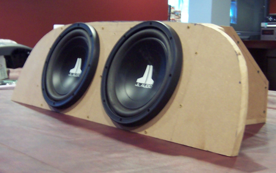

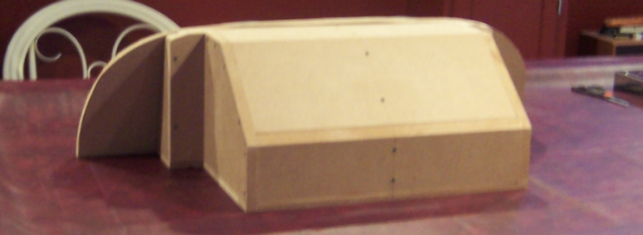

Most of the equipment is a little older but hopefully it will work for me. So far I have run all the wires for the amp and speakers in the car. Just in the finishing stages of building a custom sub box. I like the understrut sub boxes as it leaves some space in the trunk but always thought the subs were a bit too close together and I wanted something slightly different. I made the opening at the front slightly larger to better space out the subs, and I also angled the front a bit so the top will be recessed under the strut bar by 3" with the bottom flush.
I will update as things get done.

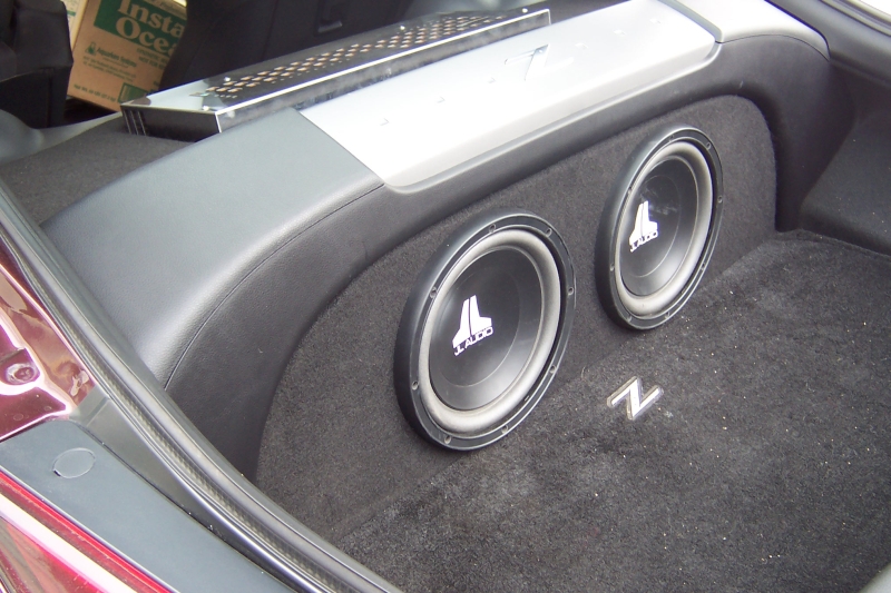

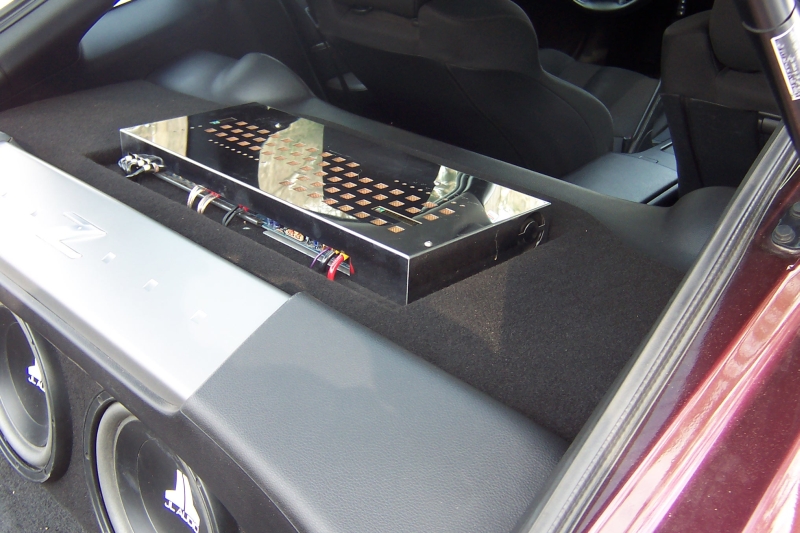

sub box and amp rack installed.

I wasn't really happy with the sound of the subs so I rebuilt the box a bit closer to the recommended volume. I increased it from about 0.480 ft^3 per sub to about 0.67ft^3 per sub. This took out most of the angle of the front but should still look good, like any other under strut box but with the subs further apart. I will update the pics when it is carpeted.

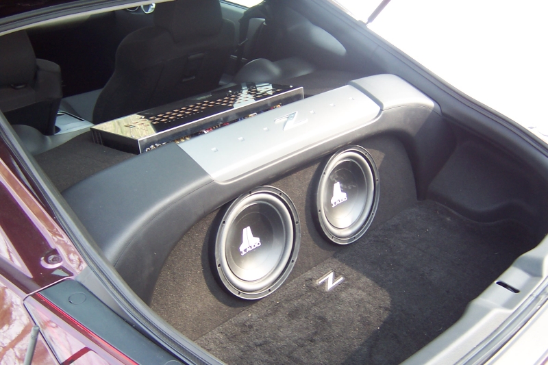

I actually rebuilt the entire box to get almost the exact size recommended for the subs roughly 0.67ft^3 per sub. The 2 chambers are divided and these are not the origional version subs. I later found out that most of the issue was due to setting on the amp (it is too adjustable) I lost a bit of the angled recessed look after I rebuilt it but it sounds much better.
