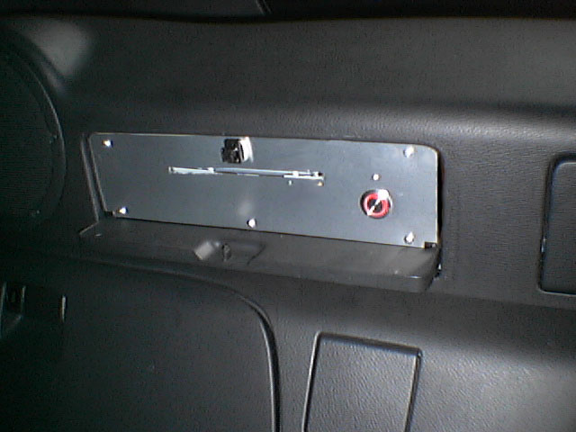

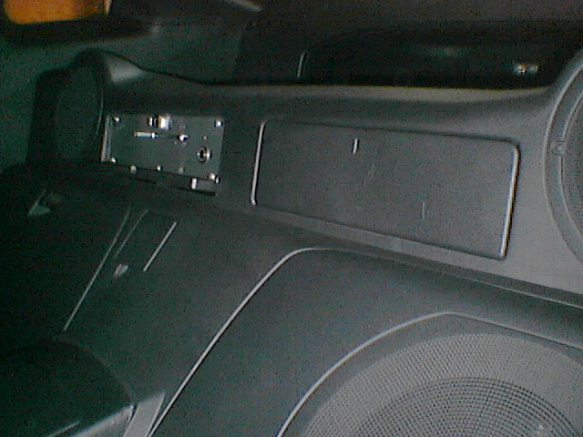

PC Revealed:
Old Sep 8, 2003 | 02:57 PM
alphared's Avatar
alphared
Posts: 2,504
From: Gehenna
Revealed:
Old Sep 8, 2003 | 02:58 PM
alphared's Avatar
alphared
Posts: 2,504
From: Gehenna
Close UP and PC Powered ON:

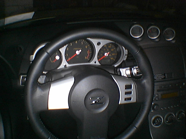

Can You spot the Changed in this PIC?
Old Sep 8, 2003 | 03:01 PM
alphared's Avatar
alphared
Posts: 2,504
From: Gehenna

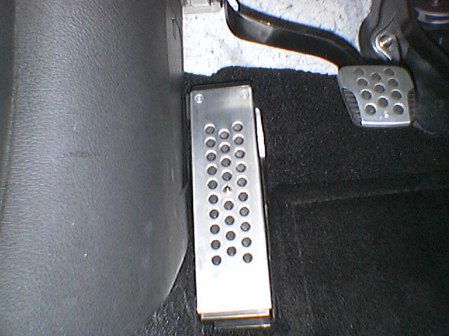

Yep. that little black dot on the lower left is the Microphone.
And heres the Button to use the Mic:

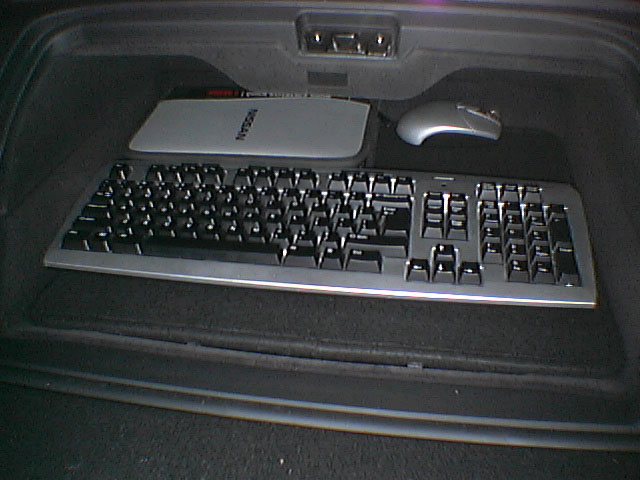

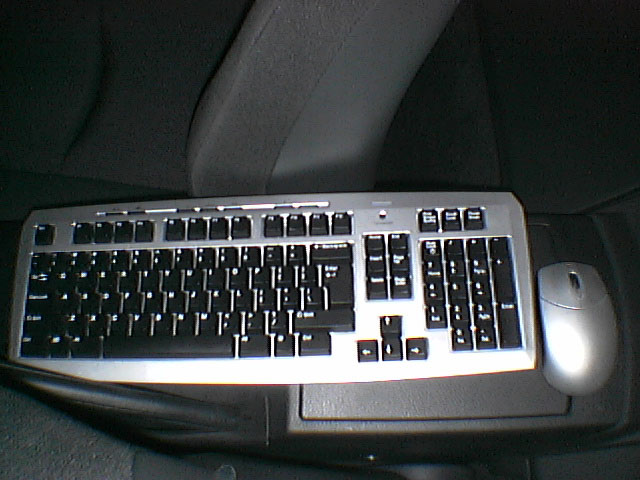

My Wireless keyboard and Mouse:
Old Sep 8, 2003 | 03:03 PM
alphared's Avatar
alphared
Posts: 2,504
From: Gehenna

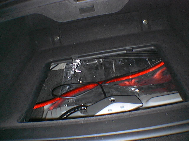

The Receiver is under the Secret compartment in the Glove box
(that red power cable is to power my Amp, the PC power cable is tucked under the front)

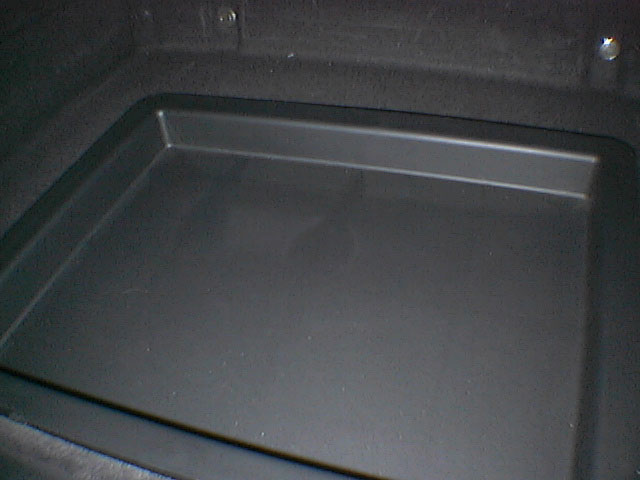

ah, can still use the Secret Compartment

My Keyboard, mouse and User Manual in the glove box. Nice Fit

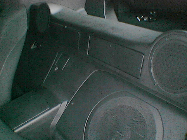

A wide shot view:

Here are some specs.
800 MHz Processor
512 mb Ram
40 gig laptop Harddrive @5400 rpm (thats the fastest I can find)
60 W PSU w/ Custom Voltage regulator
Slot loading DVD rom
Custom case and faceplate
Light up Ring power button and Clear Red HDD led
*all the above is mounted in the Mail Slot area. Bolted to the Mail Slot Support bracket
Xenarc VGA touchscreen.
USB Mic and USB audio out
Web cam in rear
wireless keyboard and mouse
Copilot (under the driver's dash)
AC adapter in trunk
AMaNDA interface
PC hooks into my AMP so sound is really nice. Can have the radio playing at the same time.

Man, I love your system, alphared. So cleeeeaaan! I wanted to do that, too. But, do you think you'll have problem with the unit overheating? Maybe you could cut hole in the plastic to provide for ventilation?
Old Sep 9, 2003 | 10:28 AM
alphared's Avatar
alphared
Posts: 2,504
From: Gehenna
Nope, no worries of overheating. The mail slot area is very open not like the glove box. If you pull the storage box out you'll see that its open in the back and on both side (rear speaker on the right of it and other storage area to the left) more than enough air flow. heck i didn't even bother putting in an extra fan. Plus the unit doesn't really get that hot anyway, its not a pentium
