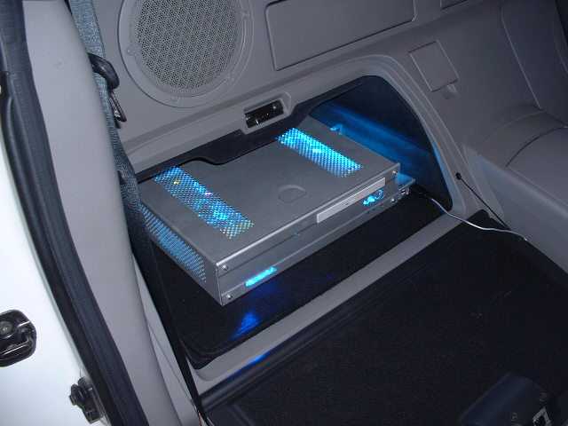

a pic of my V 2.0 unit(with optional In case Lighting)
Originally posted by chazzg
Most of the "Noise" you are getting is maybe because of your power supply set up. Fm mods are very sensitive to Electrical interferences. Some of my early models had that issue. also you can try to "Turn Down" the volume on the PC. A Fm Mod is designed for Line level input, so if you but to much "power" into it it will distort the sound quality

Originally posted by onii
that is BAD ***! where did u get your parts from?
PC: Logic Supply
Screen: Digital World Wide, Inc.
