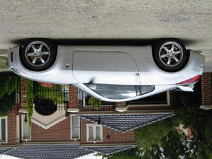

Two questions for you Richie.
1) Does the front-most "point" of the spoiler actually touch the car or is there a little space between it and the car. I though it would be tough to wash under there and I'll definitely have to devise a way to get my ZAINO under there!
2) Since you are in Austrailia, shouldn't your car look like this?

2. You are funny!!! hehehe.... well... due to the gravity of the earth, we FEEL like we are not actually upside down, but if you see it from the space, we will be upside down like that!

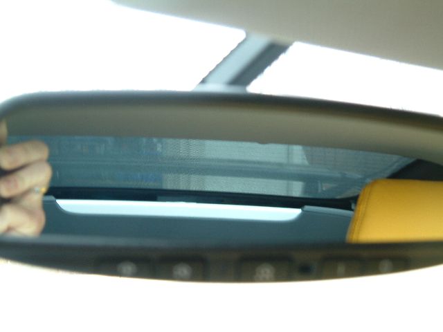

5. How much of the rear vision is affected.

Good questions I am also interested in the answers, to help out on rear view here is a pic from another member that installed a whole kit, sdpearso, not bad at all:

5. The rear vision isn't too bad, but just need to get used to it while you turn your head to the left hand side to see the blind spot... I always think the spoiler is another car just at my blind spot! Just need to get used to it, that's all!
