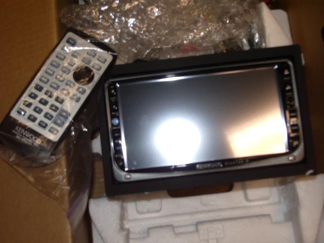

another

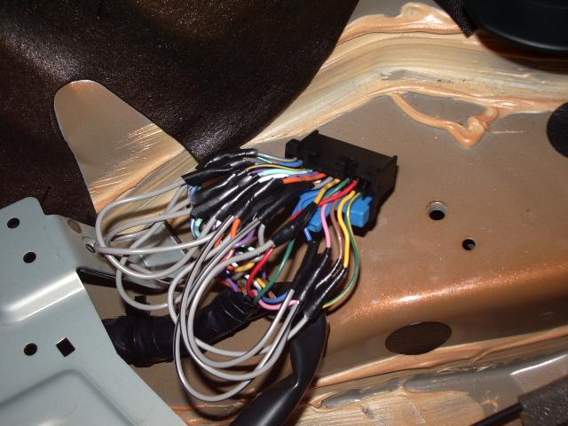

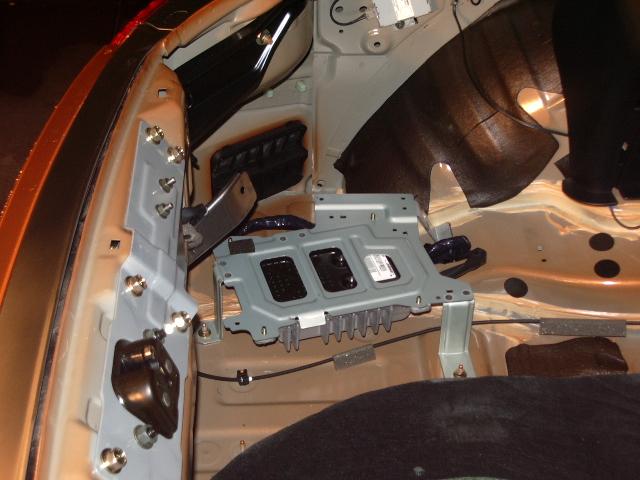

OK, all finished. About 4 -5 hours work all told. The longest task was the wiring of the speakers to bypass the bose amp (which is located in the rear hatch) The following pics show the location and the dplicing of the amp inputs to the amp outputs. Real pain in the A$$ doing this.
I'm very happy with the unit - I do get FM - only get AM in multiples of 10, oh well. I also wired an earth swith for the display so that the handbrake dosen't need to be on.

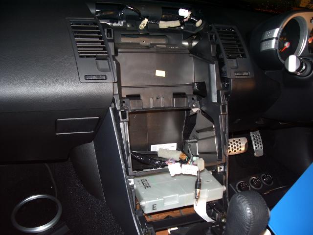

The messy splicing!!!!

console removed

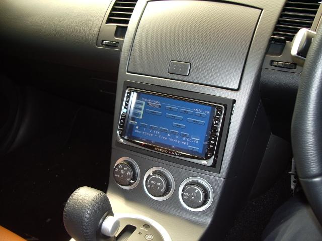

all finished!!!

looks great dude, and u did it urself, top job
as for the surround, ne installer can make up a perfect fitting piece, u could even have it cut out of aluminium to match the dial and aircon surrounds
