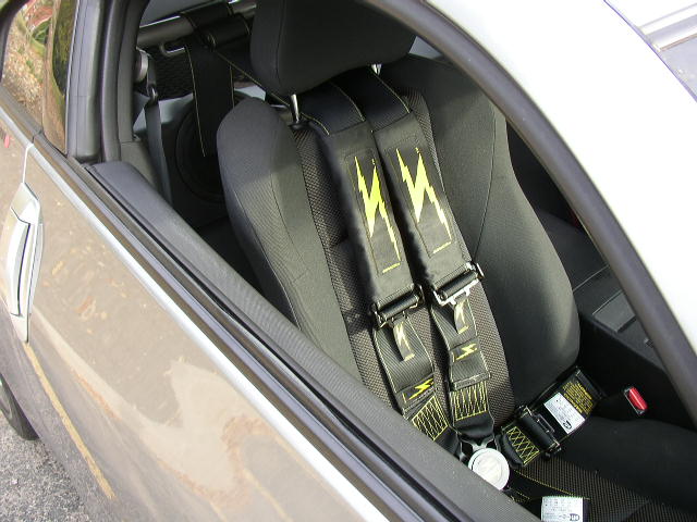

I liked my Schroth 6 point Profi III, but they had too little installation flexibility for my set-up. They are for sale.
I now run Impact 6 point harnesses, that allowed customization for drivers of varied sizes to fit & still maintain OEM seats.

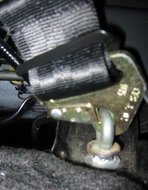

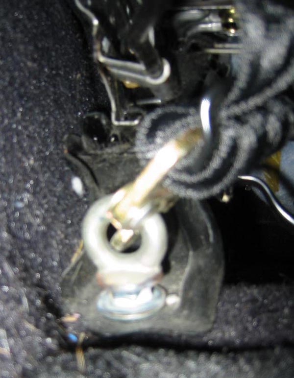

do you guys know where the anti submarine belt (ie. 5th, 6th point) bolts on to? Does it bolt onto the floor pan with reinforcement plate?
DmanG281: what didn't you like about the sparcos? they are significantly cheaper than Schroth and takata.

Originally posted by whatever
thanks for the info.
See the photos below. We used the two front bolts for the seat rail, and welded an eyebolt to the top.

Other side...
