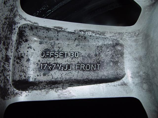

Its been a while since i've crushed cones, but in any of the stock classes, i didn't think you could run different sized wheels (beyond the 10mm offset allowance). doesn't the touring come with 18x7.5 and 18.8 F/R?

All of the Zs prior to 2006 except for the track come with the same size wheels front and rear.

this is definately wrong. i have an '03 enthusiast, and oem fitment is 17x7.5 front, 17x8 rear. its cast into the wheel. performance and touring both got 18" wheels during those years, and are, as far as I know, also staggered in width. i'm not sure what the track had - 18x8 f and 18x8.5 rear?

i think you're responding to me, so if not, sorry. again, this isn't the case. at least if you're talking about the 03's, i know my enthusiast came with 17x7.5 front, and 17x8 rear. here's a shot of the inside of one of the spokes.

I guess I could've stated that differently... I was trying to say the 17s and the Track model have different widths front vs. rear. My Touring model has 8" front and rear. Sorry about that.
