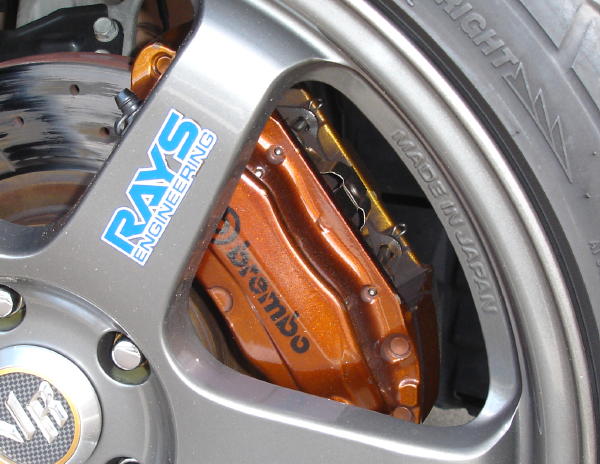

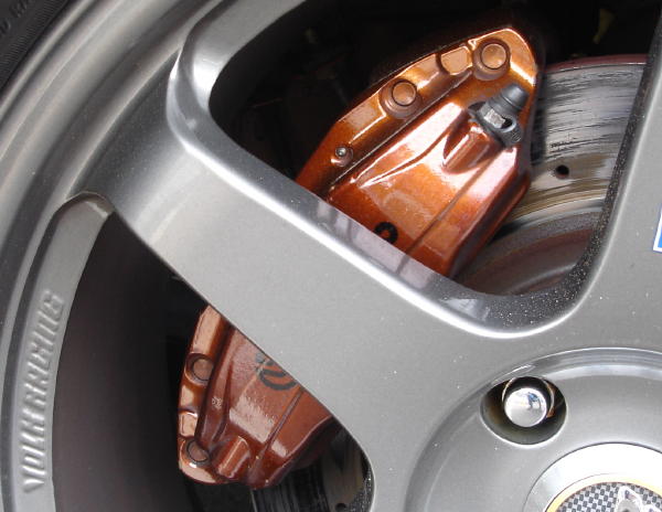

I was finally awarded these during my 5th track day, which happened to be at VIR's South Course...

also note amazing amounts of pad deposits from my burnt up Hawk HP+ pads. only carbotech from on.

Excellent job on cooking the brakes! Not many people can cook them like that. Time to make some brake ducts.

Yep, the brake ducts have to happen.
It's funny, cause there were only 5 real hard braking zones on that course, but you do a lap in about 1:30, so there isn't all that much cooling happening i guess. It was cool to watch them change, as it took place literally from one event to the next.

You know whats funny, after looking at the pics it looks like the inside portion of the caliper is the orginal color whereas the outside portion roasted. I noticed on my calipers are the same way also. The inside portion looks like it stays cooler compared to the outside portion. You would think the whole caliper would either change colors or stay the same. I guess there is air getting to the inside keeping it cool but not passing thru to keep the outside cool also.

beautiful.... finding the limits of your equipment.
next step: boiling brake fluid.
when i did my brake ducts for the mr2 it took me about 20 trips to home depot to get them the way i wanted to. basically just removed the fog lights, and there is a little piece of plastic back there that i cut to hold the duct. theyt help alot especially on smaller courses that are tight

you are right. it makes me wonder how effective the duct kits will be as they aim the air at the inside of the brake assembly as well.
i guess i'll find out once i put them on.

that is typically the way they are done, as you can't really aim it at the outside of the rotor without getting in the way of the wheel. and the brake assemblies already have the little air catchers on the dust guard things, but the best you can really do is aim it as close to center of the rotor/assembly as possible, and hope that the fact you are cooling it more than normal will help. i used 4" dryer duct, and had it pretty well hidden so it didn't look ghetto.... cost about $20 to do (and that was with buying extra crap as i tried to figure out what worked the best)....

they performed really well for the first two events i had them on the car. good stopping power and only mild pad deposits on the rotors. this last event, which was on a shorter course giving them less chance to cool down, really took them apart. i used twice as much pad during the first day as i had during the other two track weekends combined. also, they covered my rotors with pad deposits pretty badly.
i think they are good pads for the $, and will probably be OK for a lot of people at alot of events. it does, obviously, depend alot on the track and your driving style as well.

HP+ pads are STREET pads. They are not meant for track use. You will find competition style pads to be a revelation once you use them. See some good info at:
http://www.ntechengineering.com/inde...ction=datemenu
Earlier dated installments cover braking issues.

You are right. I switched to some Carbotech XP9 pads and have had nothing but great experiences with them since. I would not, however, recommend using the HP+ pads as street pads, as the noise and dust aren't worth any added bite.
