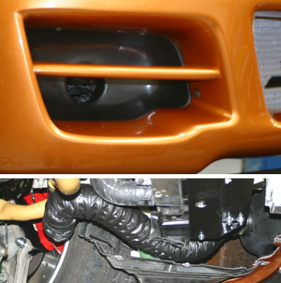

I wanted to share some pics of my homemade brake duct kit. It was pain in the rear to get the hose fed through the passanger side because of the power steer oil cooler and the windershield wiper fluid container. I had to relocate the ps oil cooler to get it to work. I custom made my brackets at the end of the hose to point it to the rotors.

bonus looks slick. what kind of duct is that?

Its 3" brake duct tubing I bought at a local autoparts store. It was really expensive though. I paid almost $60 for 9 ft. They guy at the store said it could withstand upto 300 degrees.

Very nice, you beat me to it. Did you use those plastic things in the bumper to hold them in place?

+1 Two questions. 1) How did you attach the hose at the nose of the car? 2) How did you attach the hose at the hub? I see a screw through the hose at the hub, but can't tell what its attached to. I *NEED* to do this.

Yes I did. I made the hole small enough where I had to work it in. I will try to get more pics this weekend. If you need ideas for yours just let me know.
The hole in the front of the car is small enough where I had to basically screw the hose in. That keeps it from backing out. The one at the hub uses a nut and bolt with washers and the the size of the pipe is big enough where its a snug fit.

Isn't it more effective to point it into senter of the rotor instead of braking surface?

Yes but it is very difficult to actually get the duct to the center of the rotor because of the shock and lower control arm. The bracket is cocked in order to still get some air into the center and since the rotor will be spinning it should still help keep rotor temps down.

Vlad, remember that the wheel is rotating very fast and that creates a circulation of air that is being forced into the general area. I see where you are coming from, but his design allows for a tremendous amount of needed airflow. The only that that I would be concerned about is the uneven cooling of the rotors because air is being blown on the inboard side of the rotor. Maybe because of your placement of the air exit it will vent more evenly. I have seen some that are really close to the rotor and temperature issues could have been a problem. You have a pyrometer?? That's the test there. Too bad you didn't get some before temps.

This upcoming weekend I have another track event on a 2.1 mile course with a 1/2 mile straight so I can gather some test data. I plan on running one 20 minute session with the inlets covered and then recording the temps with a pyrometer. I then plan to remove the covers on the inlets and run another 20 minute session and record the temps again to see if there is a difference and if the placement of the bracket is sufficient.

I'm sorry to be the bearer of bad news, but those brake-ducks are going to warp your disks very quickly. They will do more harm than you can imagine. What you've got there is a duct that brings cold air on one side of the disk, while the other side will rain hot. That means uneven colling of the disks (ie. will cool quicker on one side). This will bend the disk (ie. warp it) at best, and at worst may even couse it to crack.
As far as I know, blowing cold-air on one side of the disk is one of the biggest don't-dos for anyone who tracks their car as it can lead to some pretty serious failures.
Though, what you're supposed to do (and all OME braking-ducts do that), is to bring the cold air right into the middle on the disk (ie. from front on) ... that is what the ventilated disks have the holes in there for. Blowing cold air in there will distribute the cold air evenly throughout the disk. This will not cool your disks evenly, but avoid any warping/brakage of the disks. You might be able to adopt your system with minimal fuss to re-position the cool air flow like that.

Well I tested the ducts under track conditions and I had a small problem. When I put the front tires to -3 degrees of camber my wheels would rub the 3" hose and eventually put a hole it in it. I am going to trying a 2.5" tube and see if that will work.
The rotor is not stationary it is spinning meaning the whole rotor rotor is receiving air. The only problem I can see is that inside face of the rotor will be cooler than the outside edge. To solve that problem ideally I would have aimed it toward the center but its very difficult to get the duct in the center due to the suspension pieces. I cocked the bracket in order to still get some air flow into the center of the rotor.
