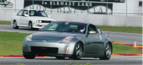

The hotchkis bars are quite a bit softer than the Cusco's. I'm running something like 475 lb rear springs though. I'm seeing about 25 degrees more tire temp in the rears versus the front temps now. I'm real close to a neutral chassis in 3rd, 4th & 5th gear turns. But having the back end come out at over 100 mph is something I'd like to tame. Here is a pic exiting T14 @ RA, top of 3rd. Note the sidewalll stretch.
Sorry to highjack your thread, but you DID ask!
I generally run 40-41 psi hot. I see nice, even temps across the tread.
Wheels are MB Motorsport Comps, 17 X 9", I think 28mm offset.
I slammed it about 1-1/4", 2.5 degrees neg. rear camber, 1.25 degreees neg. F camber. F toe out 1/16", 0 rear toe. No aftermarket adjusters....yet. I want a bit more neg. F camber.
