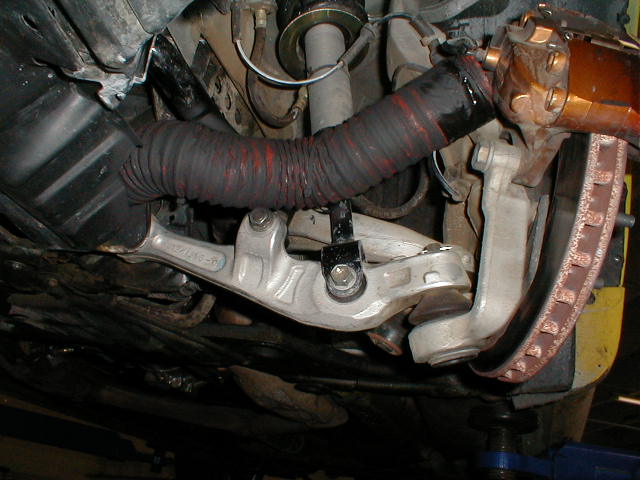

I spoke to Nissan Motorsports about these a while back and even have some pics that I can dig up. I didn't go with them because I think they can be better designed on your own (if you're not limited to T2 rules).
They draw air from the undertray rather than from the front bumpers and the hose is just directed towards the brakes with no real fitting. I'm sure it's better than nothing but one can easily do something a little better. Some members have posted their homemade ducts here.

Found em.
Attached Thumbnails Nissan Motorsports Racing T2 Brake Ducts-brake_kit_001.jpg   Nissan Motorsports Racing T2 Brake Ducts-brake_kit_003.jpg

I can't tell from the pic but is it blowing on the caliper or the rotor?

It looks like it is blowing onto the caliper, I always thought you wanted to blow it into the center of the Rotor?
Really don't like where the air is coming from - under the car, much rather it come from the front bumper.
I think I am just going to make my own one day, when I get some time. Some dryer exhaust hose and zip ties are cheap!

Ideally yes, you want to direct it to the center of the rotor. But this is better than nothing.
As for scooping the air form the undertray vs the front bumper it might not be so bad. Routing the duct around the radiator might create enough restriction to limit the efficiency of the whole system.
