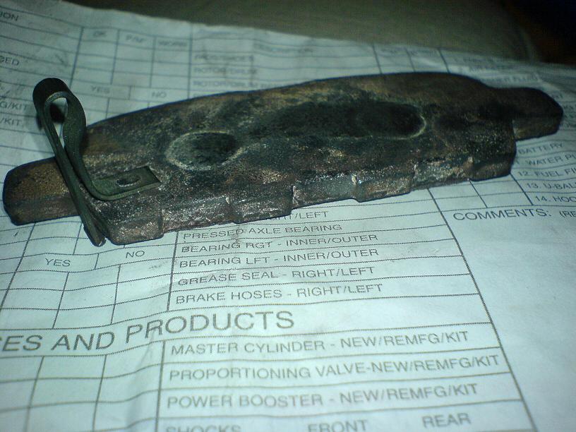

Since my rear pads are gone, decided to use my old OEM pads and skip anymore events this year . Shooting for a nice brake upgrade around xmas - easier to justify spending more money
There is also another PCA club event on 28th I think.
For the fun of it I'll attach a pic of my Nismo rear pad (originally with a nice red coating). This is how it looks after 3 Track days and about 2500miles street driving.
