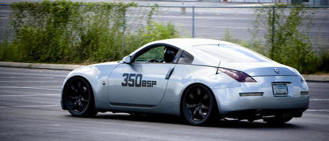

Here's a pic of my Z from this past weekend's auto-x with 275/40/17 r-compound tires mounted on four 17x8 OEM powdercoated rims. With this setup, I can rotate the tires anyway I want, and you definitely have more grip with the wider tires on all four corners. My tires are still new (14 runs) so they still need to be scrubbed some more to be stickier.

Originally Posted by z-u-later
Hallelujah! The light bulb finally turned on!
Here's a pic of my Z from this past weekend's auto-x with 275/70/17 r-compound tires mounted on four 17x8 OEM powdercoated rims. With this setup, I can rotate the tires anyway I want, and you definitely have more grip with the wider tires on all four corners.
Wow - that's a HUGE sidewall! Are you sure those aren't on a Titan! Thanks for the pic; do you have a close-up of the wheel/tire itself?

Oh, yeah, typo! Changed from 275/70 to 275/40. I'll see if I can find a closeup pic.
