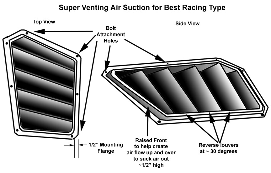

UPDATE 3/7/08
I will be making all the instructions for installation, as well as the cut out template...
the prototype edges are little longer, since i didnt know how close to cut it to the edge- i think we might be leaving at least a 3/4" flange all the way around.
dimensions are approximately 19.5" long (at the longest point) and 10.5" wide (at the widest point). Gurney flap/edge in the front is approx 1/2" tall, the rear louver is 1.25" deep, the middle louvers are 0.75" deep.
here are the picts of Prototype2.. much more flexible. its stiff but rivetable to the hood and will conform.
ontop of the hood.. these are the approximate areas where i would suggest, just make sure the rear vent clears the strut bar.. from the looks of the underside, it does not go that much 'deeper' than the factory support bar thickness.
on the bottom. (note where you will need to cut and remove material. should be fairly easy. the factory skeleton underside is just glued/pressed together to the top..

these can be placed pretty much anywhere and the depth of the fins can be altered.
got picts of your SC placement and clearance measurements to the hood?

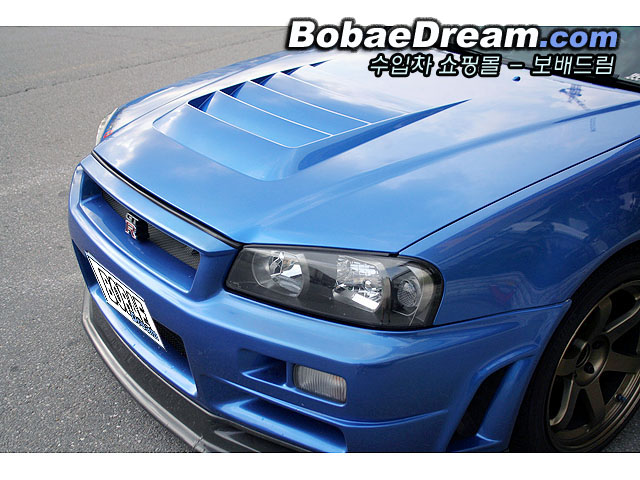

Alright, how about these?? GTR34 nismo body kit had one.. I guess Amuse copied it for the Amuse CSL hood. Isn't this the reverse louvered design?? Check it out..
Attached Thumbnails Any interest in "Drop-in" vents for stock hood?-hood1.jpg   Any interest in "Drop-in" vents for stock hood?-hood2.jpg   Any interest in "Drop-in" vents for stock hood?-hood3.jpg

Originally Posted by CUxtopher
^hope not, those are ugly. Im thinking more like a seibon hood vent or nismo v2 kit.
+1...now that would look good.
I'd stay away from the amuse style one...fugly IMO.

this was what i was thinking:
Attached Thumbnails Any interest in "Drop-in" vents for stock hood?-supervent.jpg
