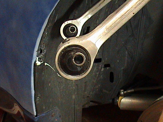

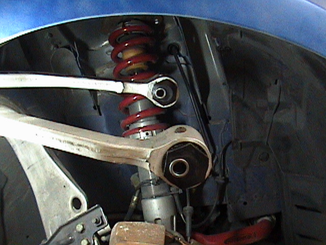

These are some pics of my upper bushings.
The reason I put a hex on one end and used a set screw in the arm is for easy camber adjustment......in case I started killing my street tires.

BTW If you make upper bushings like mine, the set screw would be a lot easier to get to if it were on the bottom.

Hippie, can you explain how you adjust those? I like the fact that I can easily adjust my evos for street and track use.

If you rotate the bushing 180 deg it lengthens the upper arm (ball joint to pivot point) and reduces neg. camber. I can't tell you exactly how much b/c I haven't done it.....street tire wear isn't that bad. I "think" it would reduce neg camber by 1.2-1.5 deg.

What keeps the bushing from rotating under normal use. Is there a locking mechanism?

Usually its an interference fit or you can use a set screw.
