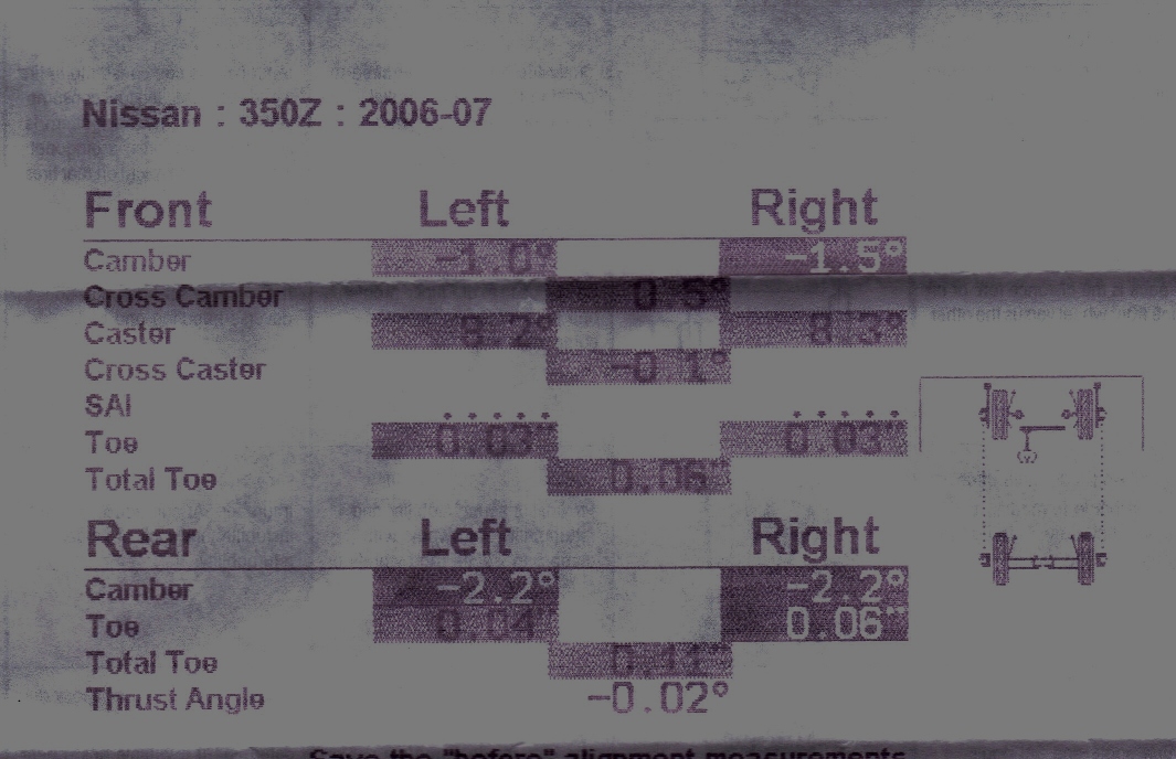

i can't say that it feels like the inside wheel is slipping... my entire rear end is sliding out. i think @ about 35-60 % throttle. now this is in a fast ( 45 - 55 mph ) turn pulling over a g.
my car is lowered on eibach coilovers and i am also using eibach sways.
tires are adavn sports . 245 f / 275r
and here is my alignment

Your rear camber is quite excessive. That combined with your lack of LSD are causing your traction problem.
Try -1.3 camber all around and zero toefront and rear. That will improve things alot.
JET
