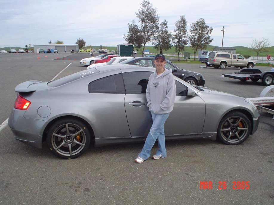

Absolutely agreed! Man I miss that G35 and its versatility. . .
Attached Thumbnails Track upgrades for G35 ?-scotts300_g35_thunderhill.jpg   Track upgrades for G35 ?-scotts300_g35_miata-day.jpg   Track upgrades for G35 ?-scotts04g35-2.jpeg
