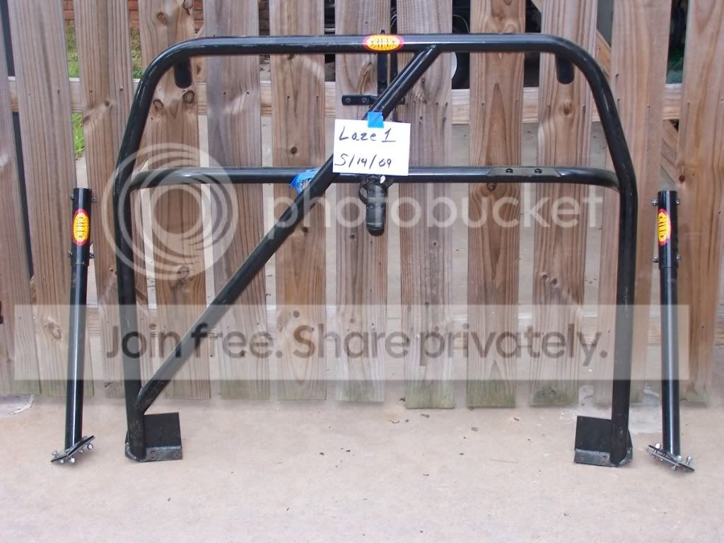

How you install the rollbar is just as if not more important that the rollbar itself.
Bolting it to the plain sheet metal of the floor pan just doesn't work.

scary.......But bolting can still be strong enough right? Just gotta find the right places to bolt to.
bolting is perfectly fine.
This bar did not have any diagonal supports, the backing plates were the wrong size (as well as the tubing size), and the install was done incorrectly from what I have seen.

Posts: 3,493
Likes: 19
From: georgia
Did the occupants come out of that okay?
The installer of that bar is going to catch hell for sure.

I've heard that it wasn't a legal roll bar at all, but was mainly for "looks."
It's a good thing that he came out alive, because "looks" don't buy crap when it comes to safety.
