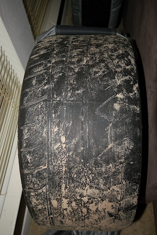

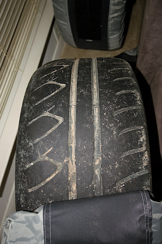

Originally Posted by Sharif@Forged
.... Can you take a profile picture of your front tires?..
Here are some shots I took of the front tires

if you never hit the track... yes, it's a lot of camber and these are my front after few track events ( I run also a quite generous open toe) and 5000 miles on the street:
and the rear
