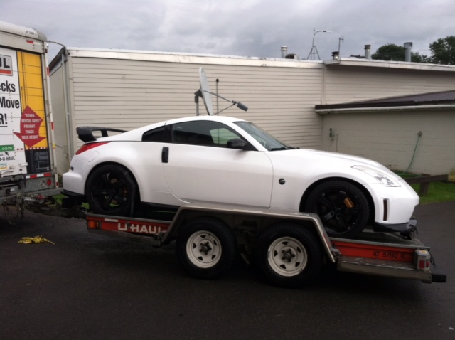

I had to trailer my nismo halfway across the country when we moved on a uhaul flatbed car hauler pulled by a 20 foot truck... it was like driving an 18 wheeler. Getting it loaded in the rain was a real pain in the a$$. I had to load it on backwards because the front diffuser would not fit over the lip of the trailer meant to stop the car from rolling off. Due to the rain the rear wheels kept spinning and sliding the car at all the raised areas of the trailer. The net-like wheel straps held the car pretty well though.

This is exactly what I wanted to see. Gonna start tracking my Z and don't own a trailer yet but considered using UHaul for the time being. Other than reversing it on, did you run into any other issues? I heard the UHaul trailer has has small spaces for the wheels? It was recommended to fill it with wood or something so that your wheel doesn't get stuck in there. Do you have any other pictures of it on the trailer?

Reversing on a trailer with a Z is a bad idea. Most of the weight will be at the back of the trailer and act as a pendulum to upset and cause trailer sway or worse jack knife. Dont do it that way.
Trailering is all about common sense. Think it through and go slow.

^tongue weight and tow vehicle would probably be the determining factor for me. With the uhaul truck its probably fine, from the looks of it, it still probably has some weight on the tongue. Shoot for 10% of your gross trailer weight.
If you drive a drw or truck with stiff suspension you are likely fine...eg, 2500, 1500hd, or 1500 with load rates tires/helper springs...150/1500 range truck or less im being extra careful. Probably well within rated tow capacities, and the weight distribution, though not ideal I concede, shouldn't be a problem if you keep your speed and distance in check.
Good shocks help a lot also.
The speed I see people towing at these days blows my mind.

Yep, you want about a 55f to 45r weight ratio. Personally I like a little more but I have a vehicle and hitch that takes a lot tounge weight.
