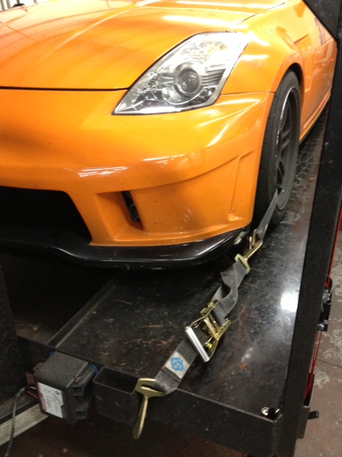

As far as strapping goes, you can always run the straps through the rims or front and rear frame supports. . If you do that option though you can not cross strap or you will change your alignment. A dove tail should be just fine for your car and an open center gives you the option to work under the car like a lift at events. I will warn you once you start trailering you won't want to go back.
I use thru-the-wheel straps on all 4 wheels...
I have tried most other methods...but like this the best. The primary advantage is that you will not burn your hands/arms and get covered in crap when strapping down a hot car after an event.
And I believe the car to be secure on the trailer as well!

I just run something like this thru the wheel spokes ...make sure to loop them thru the wheel on the side facing the trailer tie-down point...then attach normal ratchet straps to these...

In the rear I cross the straps and everything is under the car..but is it pretty easy to get to that area, especially if you have a dovetail trailer. The straps go all the way around/thru the wheel/tire/rim.
In the front I loop the straps on one of the wheels spokes, (NOT around the wheel/tire/rim) down low, and run them almost straight forward to the trailer tie down points. NOT UNDER the car... Pretty much HAVE to do the front this way as the car is too low to run anything under it without ripping off the front valence.

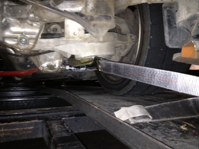

there is a hole at the lower control arm. I am not sure if that's a ideal location, but I have been towing a few times with over 300 miles each trip without problem.
