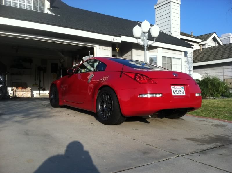

Back in it's streetcar days on TE37's

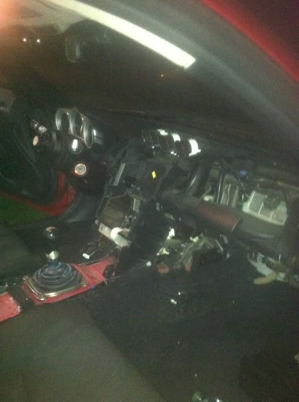

Started stripping

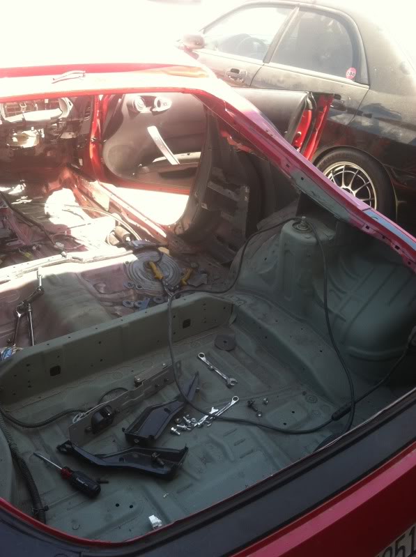

Removed the A and B pillar covers because we will be removing the roof skin when we build my cage.
