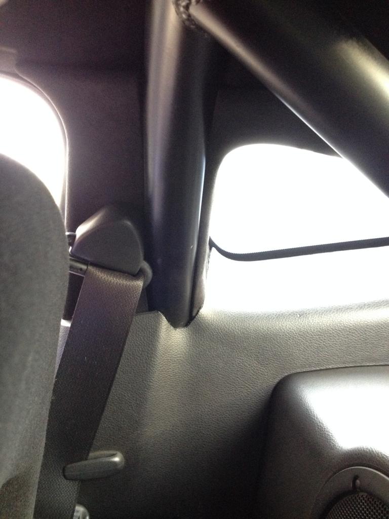

These photos are not the best but you get the idea of how far back the main roll bar is located.
This first picture I'm in the passenger side seat looking backwards behind the driver's seat so keep in mind it is on a slight angle, but it is 6" from front side of seat to the bar (6" or more from my head to the roll bar)
Here are a couple photos showing where the bar is in relation to the side window like you had asked for. The bar is just behind the OEM seat belts and just in front of the side window by maybe 1/2".

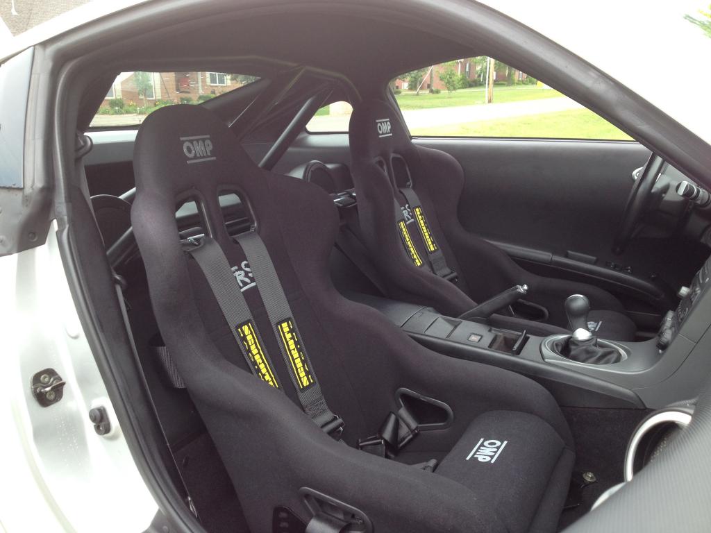

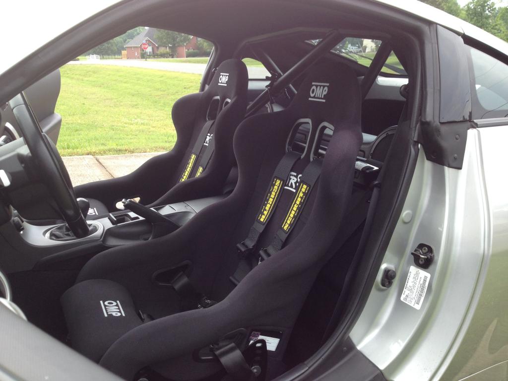

Couple photos of the interior to get an idea of the roll bar location.
Hope these photos help, as it took me a long time to decide what I wanted to do (harness bar, Kirk, custom, etc) before I ever made the decision to go with a custom roll bar and I could not be happier.

Wish I had more pictures from the install, but my roll bar down bars do not go to the floor behind the seat, they go through the speaker box area along the B-pillar. The installer cut back a section of the speaker box sheet metal to allow them access to the base of the floor under the speaker box area then stitch welded that piece they took out back in place. If position my seats back as far as possible, will get closer to the roll bar, but will contact the floor sheet metal before it hits the roll bar. This photo is looking at the passenger side which is back a little further than the driver's side.
