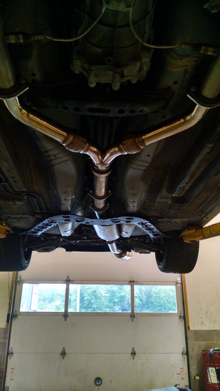

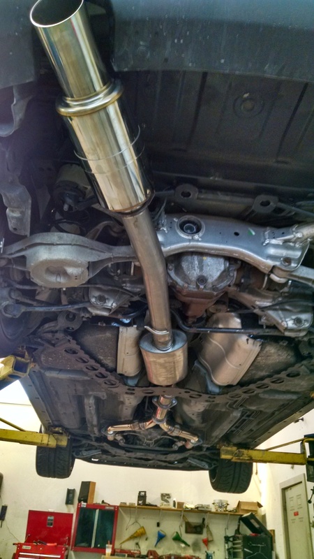

Re-installed the 3" single exhaust yesterday with a Borla XR-1 split core muffler added. It was a tight fit. Hoping I don't kill this thing with lack of ground clearance. The lower part of the muffler is equal to the W brace.
It's still too loud above 4k. ;( Idle, cruise and low-mid load are not much (if any) louder than stock, just with more rumble. But WOT is not much different than before the muffler. It's not as raspy, but sound level is still up there.
Burns 2 stage muffler on the way. It should be really close to just replacing the slip fit fart can on it right now. Worst case, I make a cut in my piping and have to add a tip to the muffler. This has got to be the most expensive single steel exhaust ever.
If the muffler doesn't get here before our next event on the 16th, I'm considering making a turn down or deflector.

A lift in the garage... I wish!
What muffler is that...? I have a Greddy RS single muffler with the Motordyne resonator and so far the SCCA Sound Police haven't nailed me!
Old Jul 14, 2016 | 06:22 AM
  #40
cbax's Avatar
cbax
Joined: Aug 2015
Posts: 53
From: Maine
Lift is at my buddy's shop. I wish I had one in the garage.
It's a Borla XR-1 split core. Sounds fantastic. Either I'm getting used to it, or it's mellowing down some. I also picked up a slip-on turn down from the parts store, trimmed it up and made a steel mesh screen for steel wool. I figure I will show up this weekend as it is and see how loud it really is now, then I'll toss the turn down on if needed, then the steel wool if needed. The dealership sponsoring this one has a gutted wrx that is fairly loud. As long as I'm not that loud, I should be good. Next event has no sound restrictions, old air base by the Canada border in the middle of nothing.
