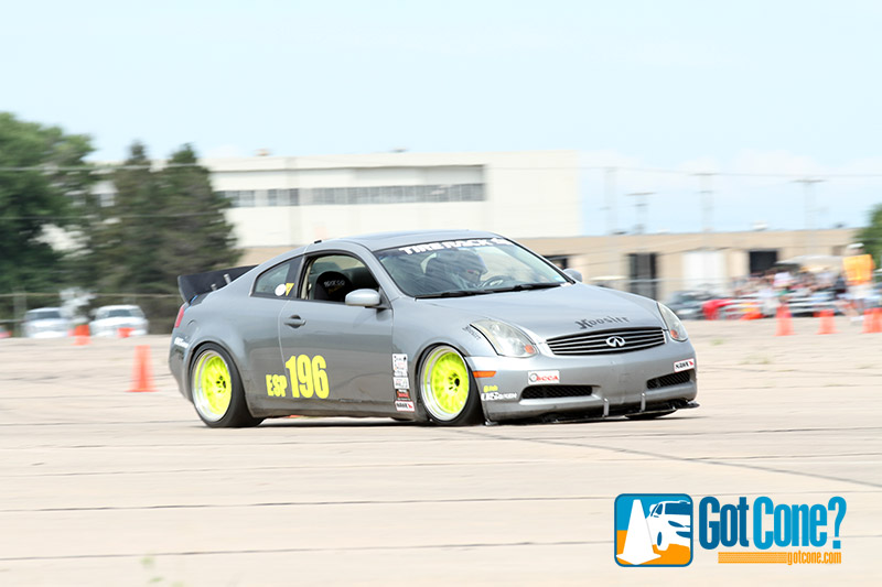

Hi guys. Im new the forums and new to the platform. Joined here after realizing that there is virtually no autocross presence on the G forums.
I live in Maine and regularly autocross with a local non-SCCA club. But I also try to get to MA to run with NER a couple times a year and plan to make it to some NH events next year. Ive got around 5 years of autocross experience, mostly in a SM Evo that I sold last winter, the last 2 years were full seasons. This year has mostly been with my '08 Mazda 3 in STF.
Every year we head up toward the Canada border and do a 3 day event at Loring Air Force Base. The place is HUGE, land speed record huge. FTD for both competition days were around 1:15. The S2Ks and Miatas were hitting 4th in places. Our club allows you to run 2 cars So every year we beg, plea, borrow and steal each other's cars to double the seat time and have more fun. This year on Saturday I was graced with the opportunity to revive my love in a BS Evo, which was a blast. And on Sunday, I was offered an opportunity to drive an '04 track pack G35. Hell yeah. I had never really paid a ton of attention to the Z or G until a month or so ago down in MA, drooling over PJ's ESP G35. I had the most fun Id ever had autocrossing, even though my STF Mazda was over a second faster.
Here are a few pictures from that event. Not a clean run! (or car!)
After coming off one of my runs with a huge smile on my face, my buddy makes sure to tell me that everything he owns is for sale. I carried on throughout the day and continued having a great time. Two days later, I asked him what his bottom dollar was and he gave me a price I couldn't refuse. Bought it that next weekend.
- 2004 G35 "Track Pack" w/ the 6mt and Brembos
- 75,000 miles (no winter)
- Godspeed front sway bar
- Cusco front A arms
- 18x9.5/18x10.5 Miro wheels with 255/275 Nitto Invos (we were running square 275s and different wheels at Loring)
- Intake plenum spacer
- Takeda intake
So...mostly stock. The plenum spacer puts it in ESP at the moment, otherwise STU. But with the (lack of) difference in PAX between STU and ESP, ESP it is.
