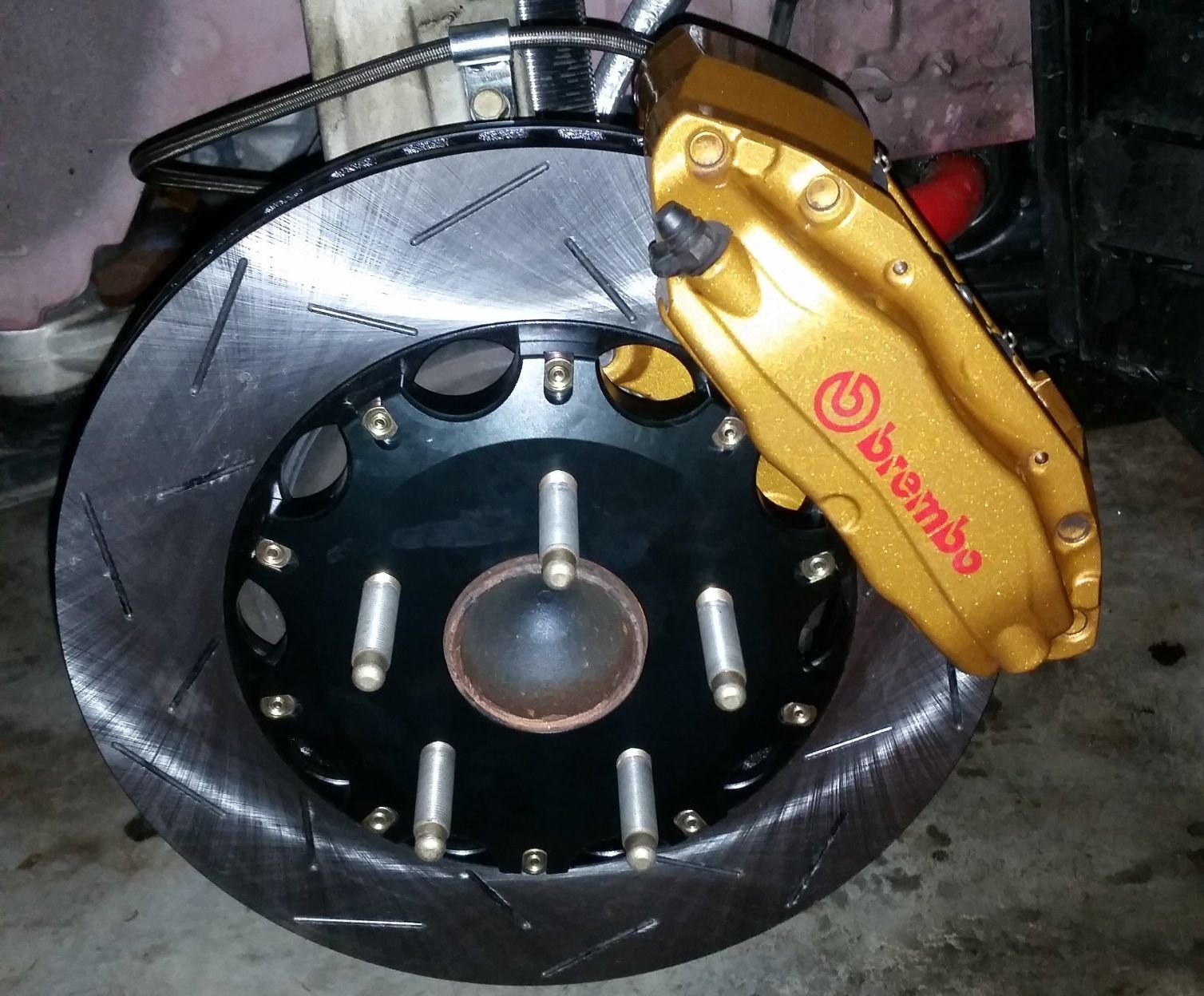

Here recently I've just been driving my Z trying to get used to the handling. During the Black Friday sales I got some of the Z1 2 piece rotors and SS lines to go with the used Brembo calipers I had purchased a while ago. I finally got some time to start putting them on the car this week.
First was to rebuild the calipers. Even though they looked very clean and the seals looked good I wanted that extra warm and fuzzy feeling knowing the seals were replaced:
Next I got the car up on the stands to start the installation:
Then I got all the pretty parts installed front and rear:
Tonight I plan to bleed the system using my Motive Power Bleeder. Then I'll go out later this week and bed in the new pads (Carbotech AX6) and rotors.
I wanted to know if the money spent on the rotors and such was worth it. I know Z1 claims weight savings over stock Brembo parts but couldn't find much information on the weight of the stock '07 brake setup. So I measure parts coming off the car and parts going on the car using a bathroom scale and if light enough (<10lbs) my kitchen scale. Here's what I've found:
  • Brembo Calipers no pads (ea): Front: 7lb 2oz Rear: 3lb 8oz
  • Stock '07 Calipers no pads (ea): Front: 14.5lbs Rear: 6lbs 2oz
  • Z1 two piece rotors (ea): Front: 16.0lbs Rear: 15.0lbs
  • Stock '07 86k mile rotors (ea): Front: 21.5lbs Rear: 13.5lbs
Doing the math in the front I saved 7lbs 6oz per caliper and 5.5lbs per rotor. The rear saved 2lbs 10oz per caliper but gained 1.5lbs per rotor. The rear rotors are substantially bigger in diameter (have to cut the backing plate to fit) so I assumed they would be heavier but minimized the weight gained with the 2 piece (Z1 claims 2.5lbs lighter for their 2pc rear rotor vs a factory Brembo rotor).
  • Overall total weight savings front: 25lbs 12oz
  • Overall total weight savings rear: 2lbs 4oz
I like to do HPDE/PDX/track days and hope to start doing them in the Z this year so that was another reason for the upgrade. I hope the weight savings might help a little in auto-x as well.
I did weigh the Z1 SS lines and hardware at 1lb 2oz but didn't measure all the OEM lines and hardware to see if there was a difference.

Some serious weight savings with the Brembos over the standard calipers! I've wondered on the weight savings with the 2-piece Z1 Brembo rotors over regular 1-piece blanks. I think I have some new-ish Brembo rotors in the garage
Z1 claims 5lbs front and 2.5lbs rear for each rotor over standard Brembo rotors. It would be interesting to see what weights you get for the standard Brembo rotors.

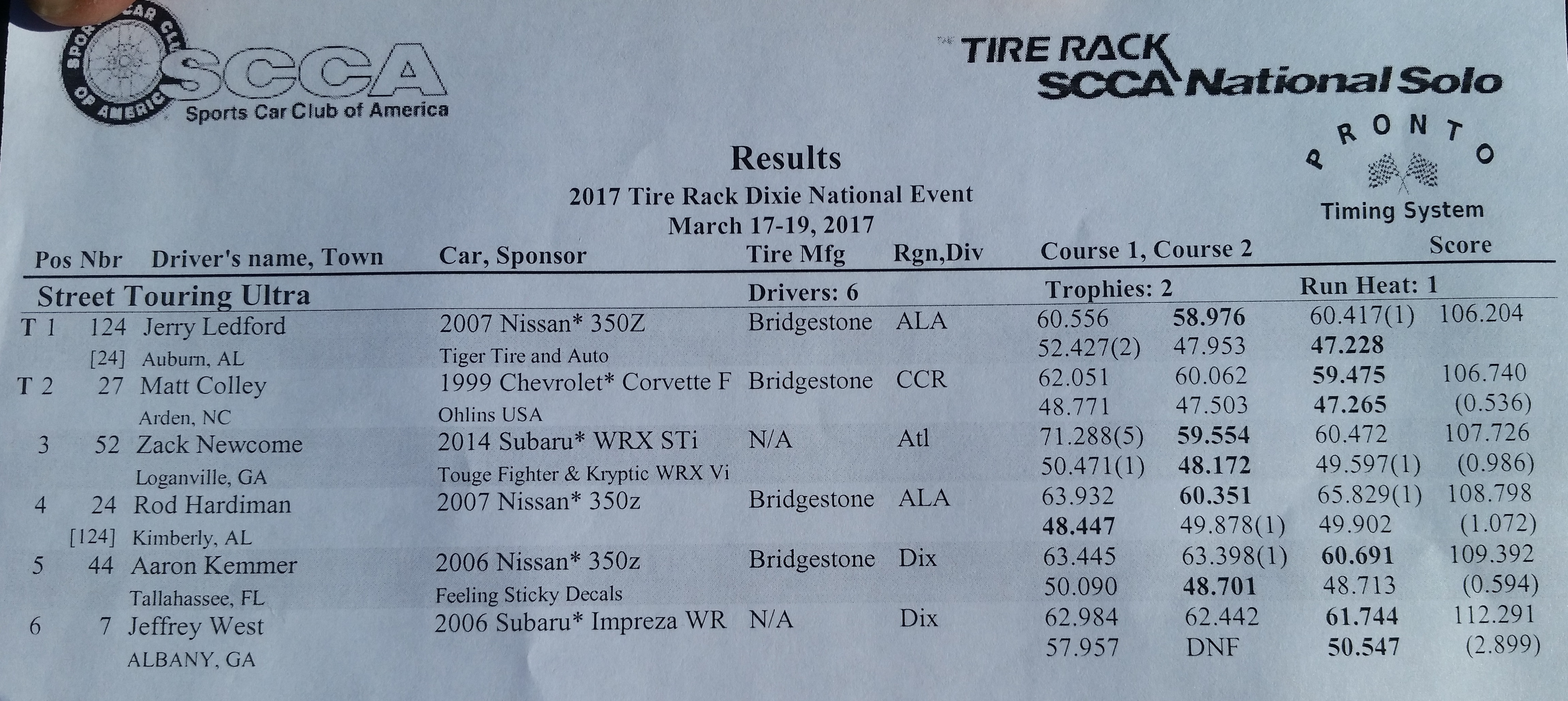

So Z1's dyno was (maybe still is) broken and I wasn't able to get the headers and hi-flow cats on the car then tuned before Dixie as I had hoped. I did still go to Dixie over the weekend and was able to take my first National Tour win in my own car!
(I won FS at the Mississippi Match Tour last year as my first win but as a codriver).
I had some good competition from an FRC Vette and a newer STi over the weekend. It came down to my 3rd and final run on Sunday and I was able to pull out the win. I was also able to have the fastest STU runs for both Saturday and Sunday.

I've got the vids uploaded from Dixie this past weekend. Saturday's runs are the 1st run due to technical difficulty the fastest runs weren't captured. Sunday everything worked great and these are the fastest clean runs.
Co-driver Saturday :
Co-driver Sunday :
Me Saturday :
Me Sunday :
