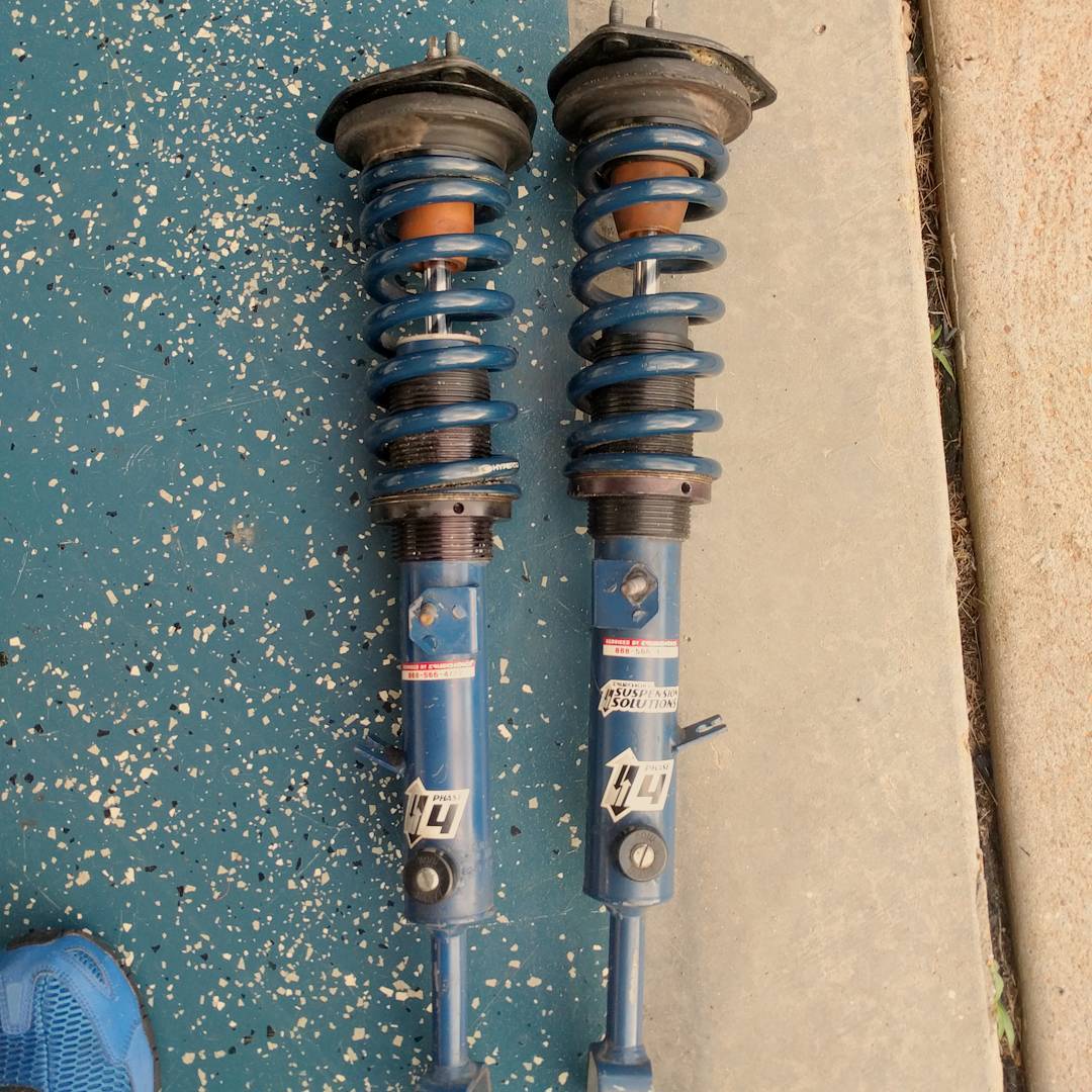

After the poor showings in the National events I decided it was time to tear the car apart and see if change is what I need. I decided it was time to put the “old” suspension back on the car. What is the old suspension you might ask, well you can read about it here, I never did sell the suspension off the old car, so I decided it was time to try that out. The car has been up on jack stands for a month now, I finally got around to getting, everything finished up today.

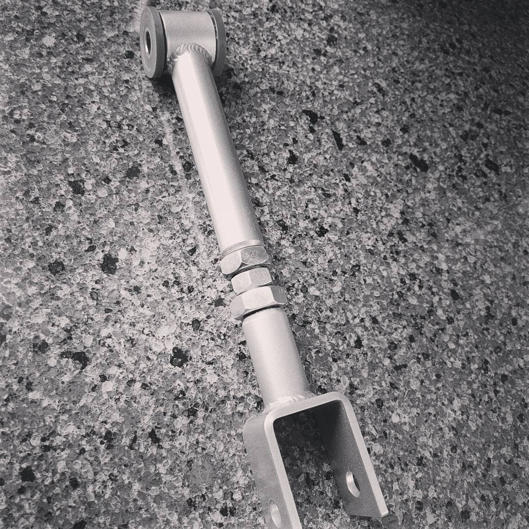

One additional thing I installed, there was a little issue with the potential legality of the previous camber arms on the rear end of the car. The arms came on the car when I purchased it, but I decided I didn’t want to run the risk of them being challenged with a protest at a future event. So I ordered the Kinetix Racing Rear Camber/Traction package, though before installing the Toe arms I reread the rule book, at the encouragement of Greer, and realized that the toe arms are illegal in STU. So as part of the work today I installed the Camber arms. Later this week I’ll get the alignment done, and see how the change works at the next local St. Louis event on the 17th of July.

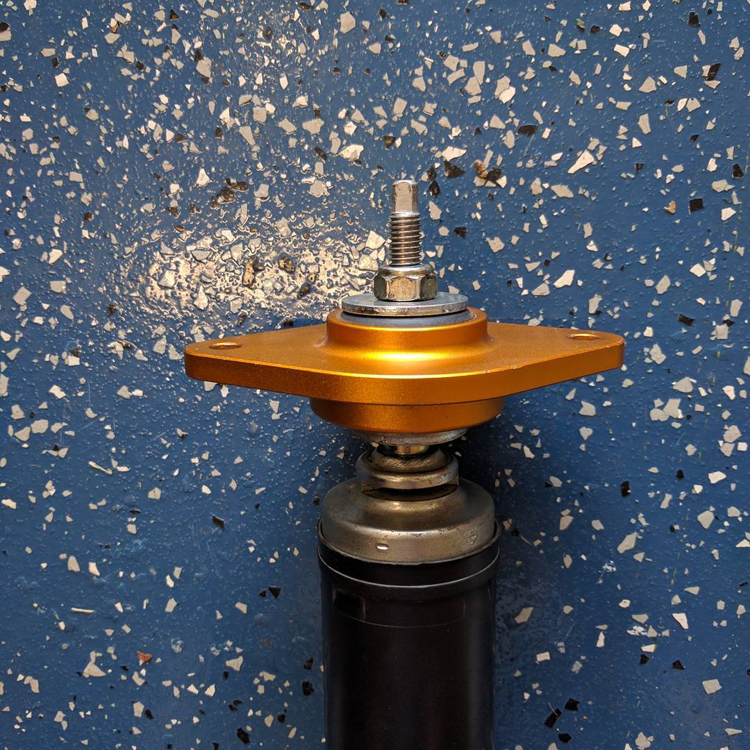

Additionally I made a few changes to the suspension, I left the rear springs on the car, the setup there, with hypercoils, will allow me to swap them out easier to a heavier spring. The other thing, also in the rear, is that the Konis use the OEM upper mount, and unfortunately when I put the OEM suspension back on #2, I used the OEM mounts, so I tried to use the mounts from ISC setup, but the shaft of the Koni is smaller than the ISC, so the bushing doesn’t work properly, I ordered the OEM bushings, and cut down the metal spacer to fit in the ISC mount. I remounted the Konis with the ISC setup and tried my best to get the alignment close to where it was when I started the process.
