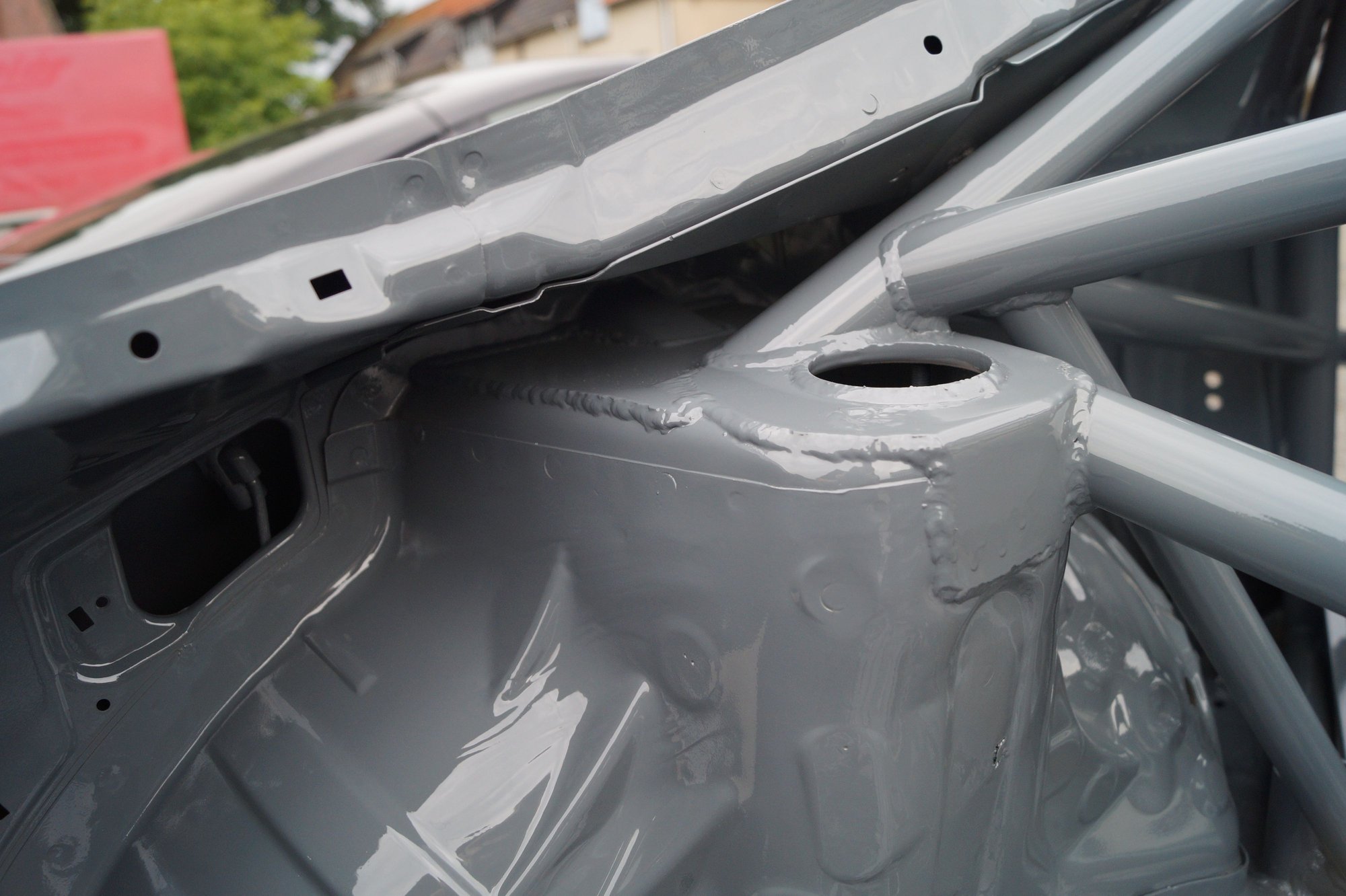

Now the the real fun began. I got in contact with schirmer race engineering and planned my future project. If you don`t know them, they build extremely fast track- and racecars. Most popular are their e92 m3s which lapped the ring (BTG) in under 7 minutes on street tires (dz03g), street registered and with a NA engine. The guy who welded my cage also build the first 350z and r35 GTR racecar for nissan in germany for the VLN racing series and the 24h race. He also constructed the cages for all SLS AMG GT3s and much more, basically he knows what he`s doing and has some amazing welding skills. He really helped me, but of course it was still really expensive so for the preparation I did everything I could by myself with the help of some friends. That meant I had to take the car completely apart. There was not a single bolt, line, wire or part left on the body. I also had to remove every tar mat and every sealing between the sheets. The worst part was to carefully drill out every single welding point and cut out all the unnecessary metal sheets (which were a lot, around 800 welding points). That included the basis seat console and much more. Here are some pics before the car went to schirmer.

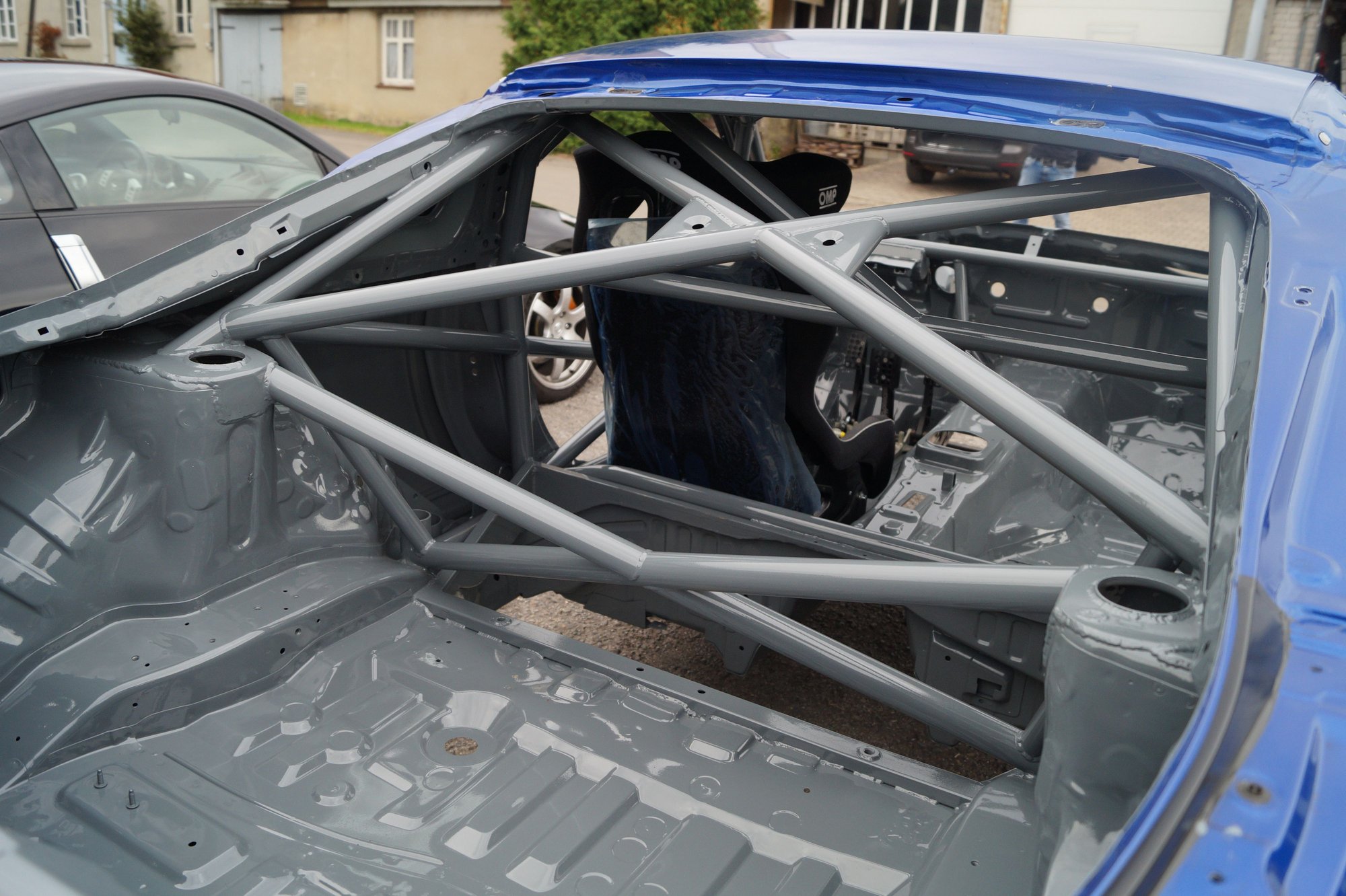

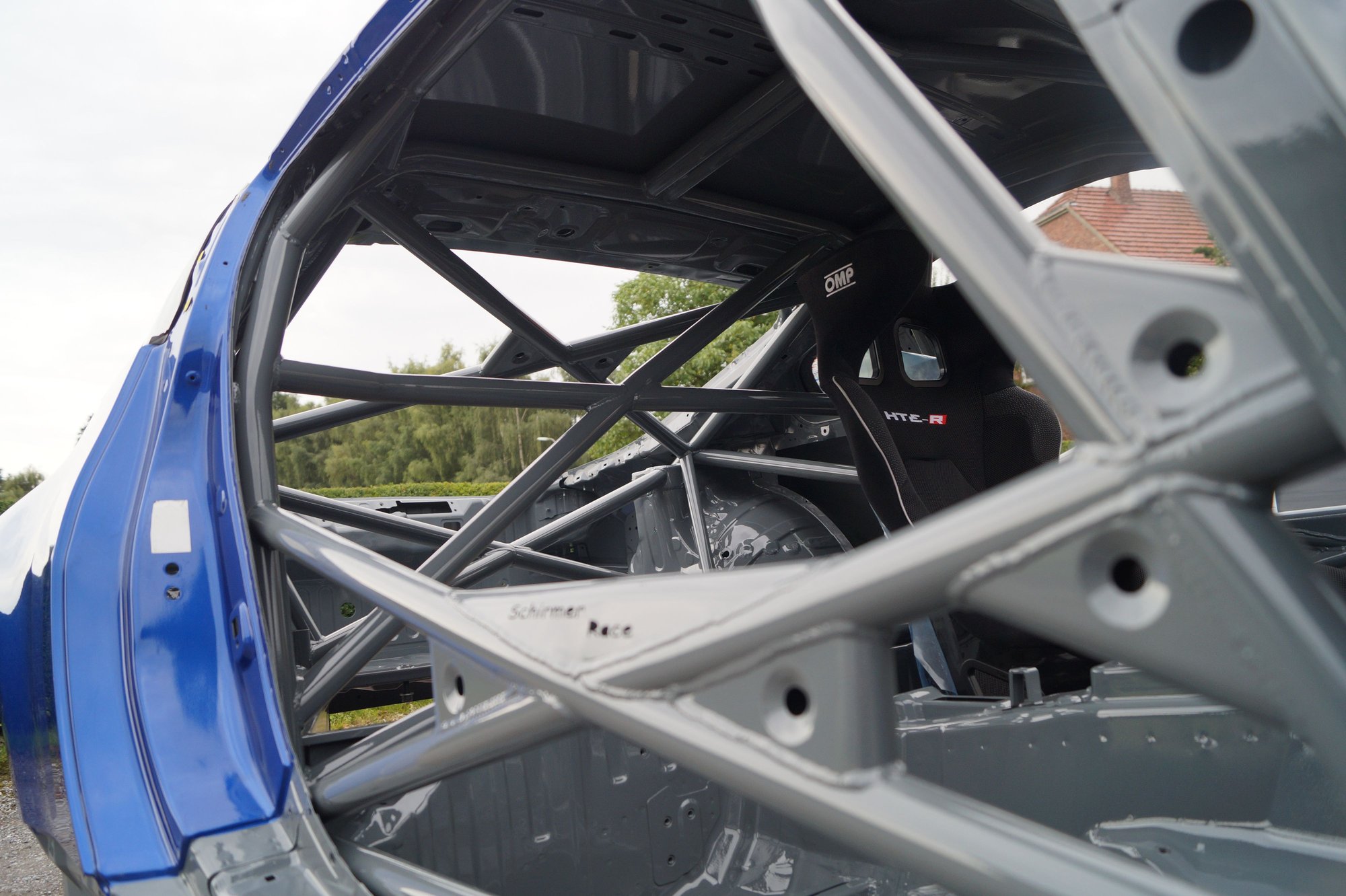

After SEVERAL year, many visits and some complications the car was finally ready to take home. Because I`m a tall guy it was really a challenge to make me fit perfectly in the car. The cage had to be embed into pillars (much to grind out and the cage is welded directly to the pillars), the seat console had to be "outboxed" (basically under the original floor) and the footwell had completely redesigned to fit me and the AP-racing pedalbox. The frame had to be opened, redesigned, reinforced and so on. He also connected all domes, reinforced them and directly connected the front and rear subframe (cut the body, welded in some bars and welded the metal sheets back on). The part behind the seats is cut out and framed to fit in a FT3 fuel cell. All in all a very elaborate build. Here are some pics:
(fully welded the a pillar, grinded out the "roof")
(fully welded b,c pillar, grinded out)
(supported rear dome)
(footwell boxed out and reinforced for the pedal pox)

(reinforced front dome and connection to the front subframe)
