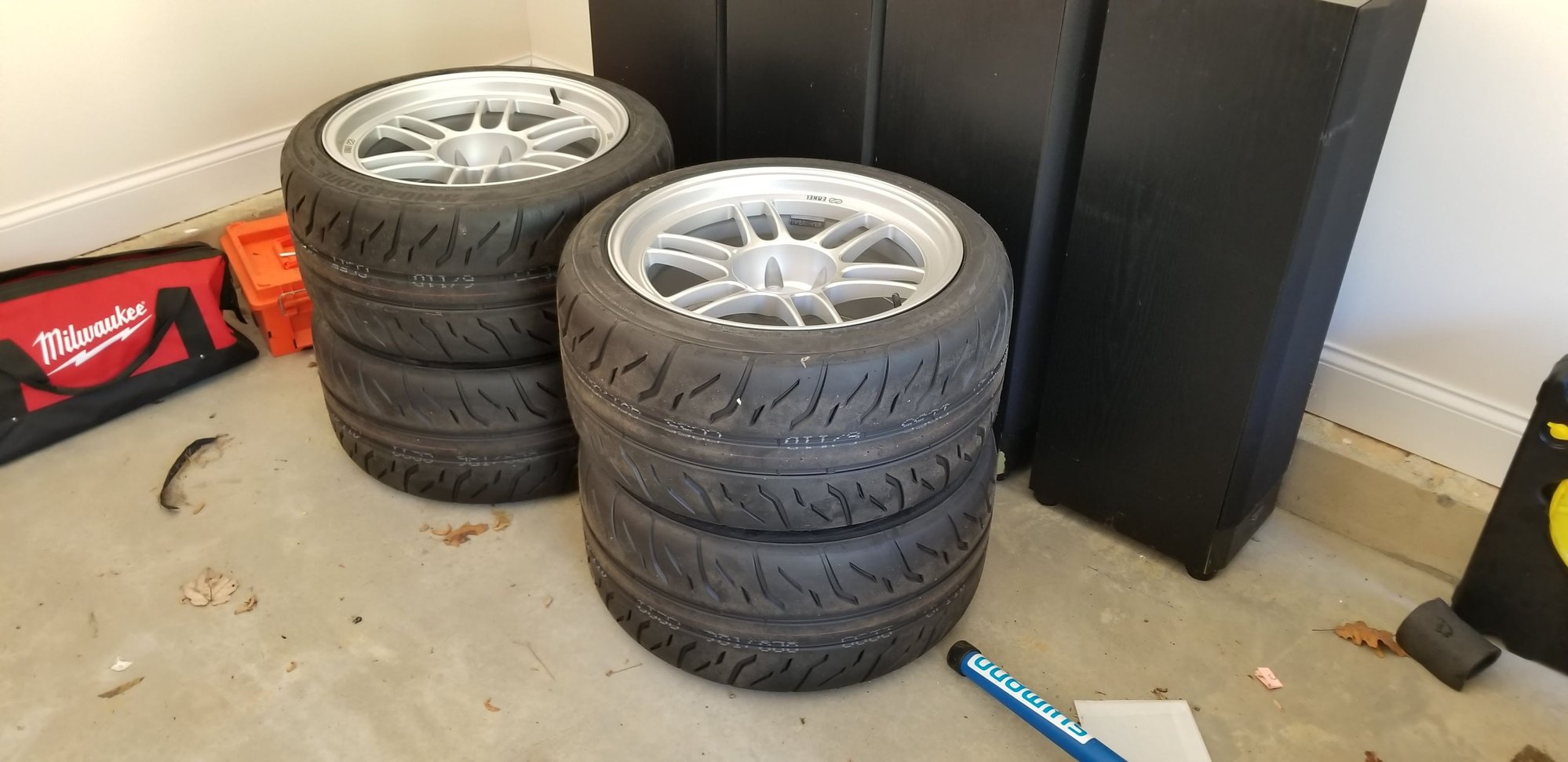

Oops. Hotchkis FSB with Whiteline endlinks. Enkei RPF1 in 18x10.5 wearing Bridgestone RE71R in 275/35/18.

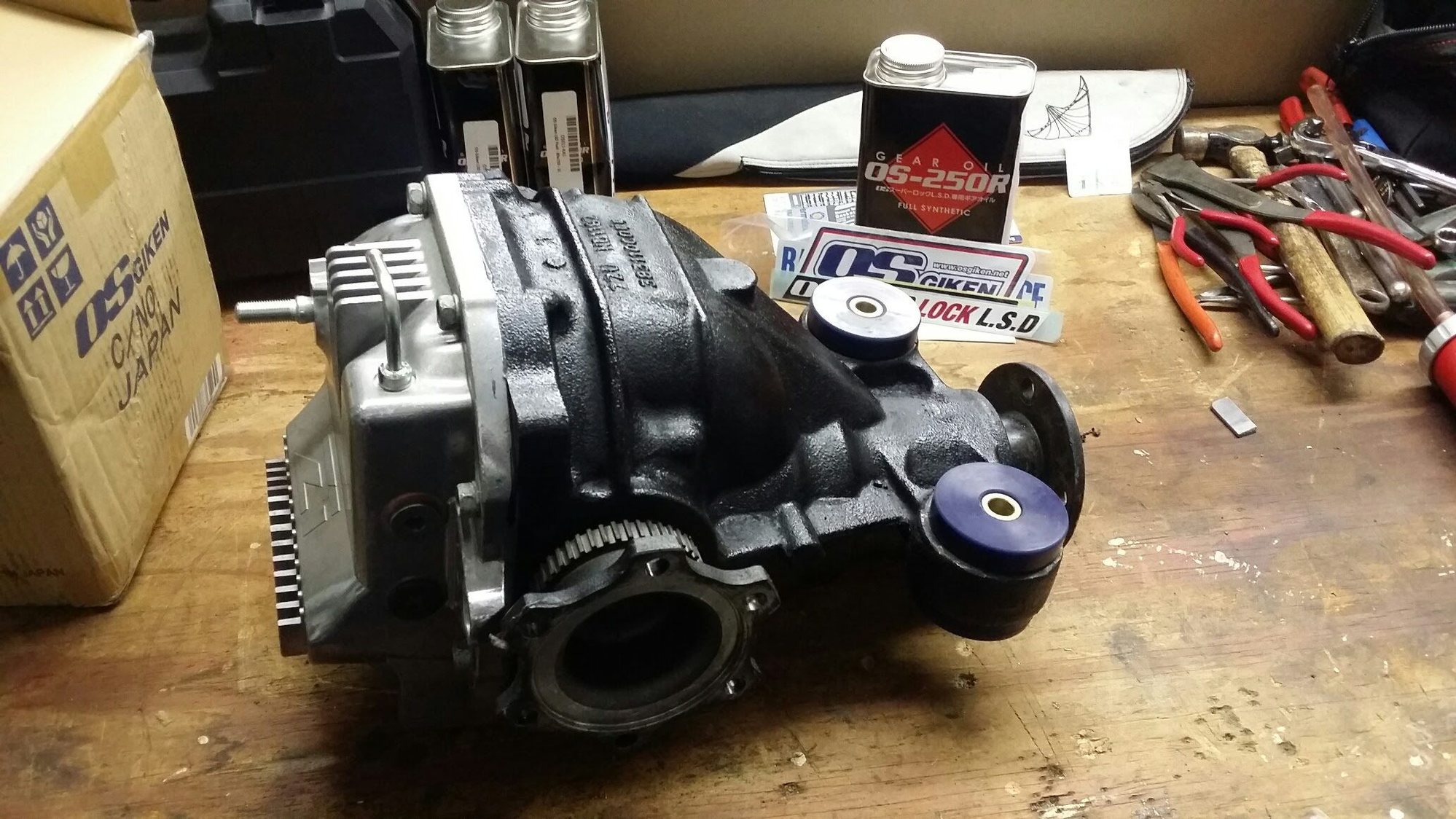

Yeah, I'm bad at the "don't modify the car this year" thing, and in went the OS Giken diff and Z1 differential bushings. Turn in and mid-corner push was so much better, you can now really steer the car with the throttle at apex to adjust corner exit. Additionally, you can truly feel the differential working and the inside tire gaining grip and pulling you towards apex. If anyone is wondering, buy the OSG - it really will change how you drive at the limit.

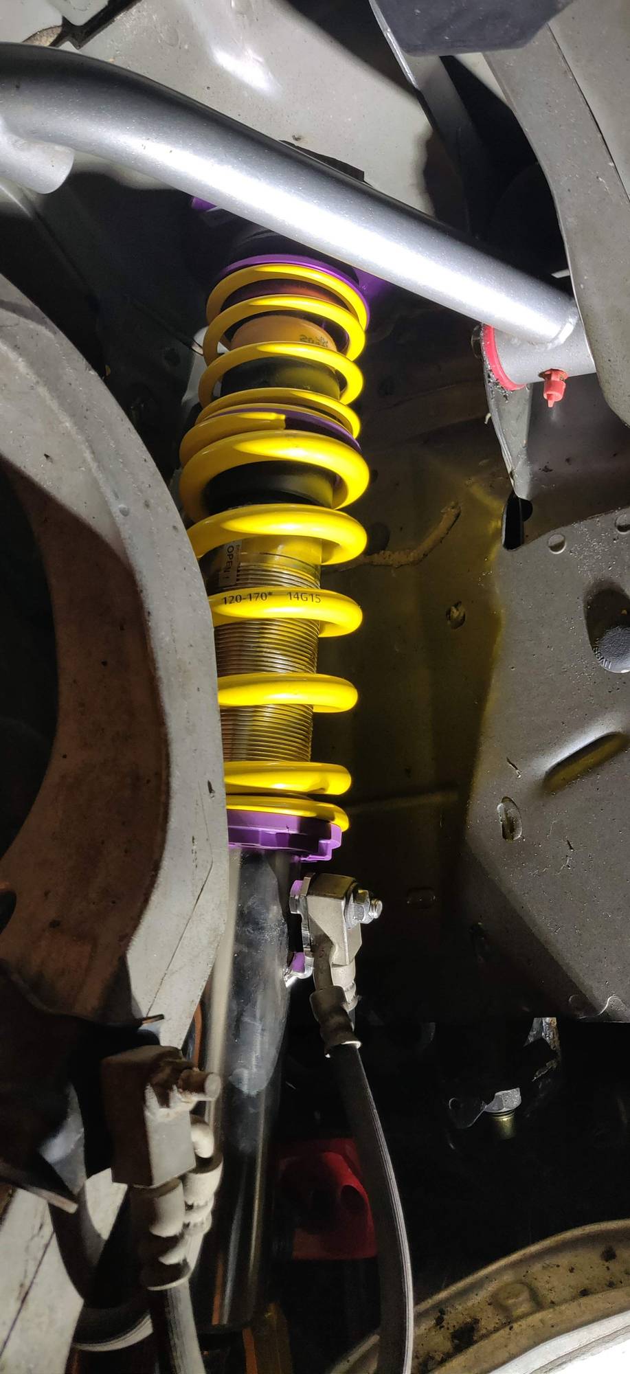

Installing the new suspension
The fronts were super easy. Unbolt old ones, bolt in new ones. Had both done in roughly an hour. Again, could carve off probably 15 minutes off that after doing it the first time. Here's what they look like in the car.
NOTE: The fronts use a 6" spring with a 1.5" (compressed) 100lb tender. This is functional, and works just fine. No issues at all.

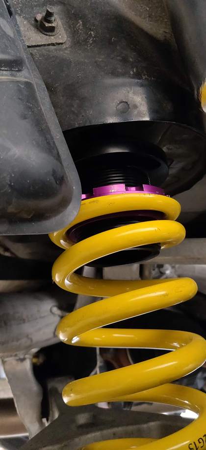

The rears, however, ship with all this hardware.
Now lookie what we got here. A tender spring (same 1.5" compressed 100 lb), a 1.5" spacer, and an 8" spring. I spent half a day dealing with this nonsense, and here's what the combinations look like.
8" spring rear with tender spring
8" spring rear with spacer
Neither of which will let the car get to our desired ride height of 5" at the pinch weld. The closest I could get them was about 5.5" with the ride height adjuster fully slammed. That may work for some, but this is racecar. SO I pulled the tenders and the spacers, ending up just using the 8" spring without additional help of any kind. For those that have been around the block once or twice on these cars, you'll know that the spring length when the car is off the ground is insufficient to capture the height adjusters, and so can fall down or lose their placement, meaning that when you raise and lower the rear end you have to be pretty careful to put them back as you're dropping the car back down. This is a pain in the ***, but clearly how the car is supposed to work in this configuration.
This is correct.
Figuring this out took two friends and a number of exchanged messages. Wasn't that fun.

That's interesting that KW uses such a large spacer for the base of the rear spring... Pretty sure that's several times larger than what BC uses, and I don't think BC includes a helper spring for the rear.

RE: KW spacer - here's a picture of the lower spring seat in the car without the spacer so you can see what it was like normally. I don't mind the way the bottom is done, but the tops are just, well, lazy. There's no capture into the body that appears designed in. I think if I had access to a full lift I could probably bend the top seat tabs around the height adjuster to hold it securely versus just using them as a positioning guide, but that is nowhere in KW's notes about it. When I redo the suspension bushings in the off season I'll likely tackle that, but that presumes I'm keeping the Spec Z suspension into the '20 season and I'm not certain of that yet.
I bought the KWs because they're a great "try it and see if it works" before jumping to 8300s or another custom-valved setup (KW actually offers a Motorsport option) and if I hate it I can get most of my money back out. 800/600 is a little soft for what I want to do with the car, but I might be able to get 1000/750 or even 800/800 depending on what I'm willing to tolerate for rebound and compression at those rates. If not, I should be able to unload the whole kit for ~2k and have had a race suspension for a season that I didn't sink 5k+ into.
