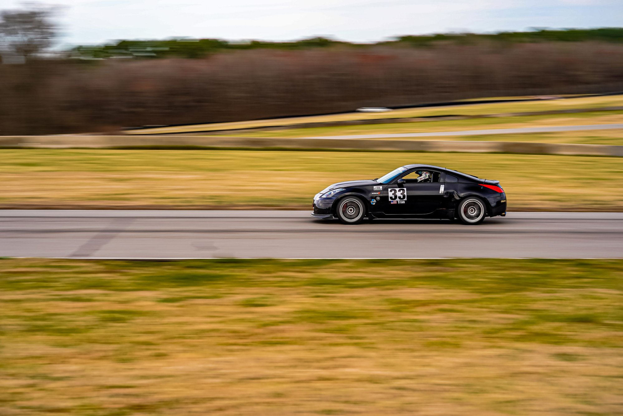

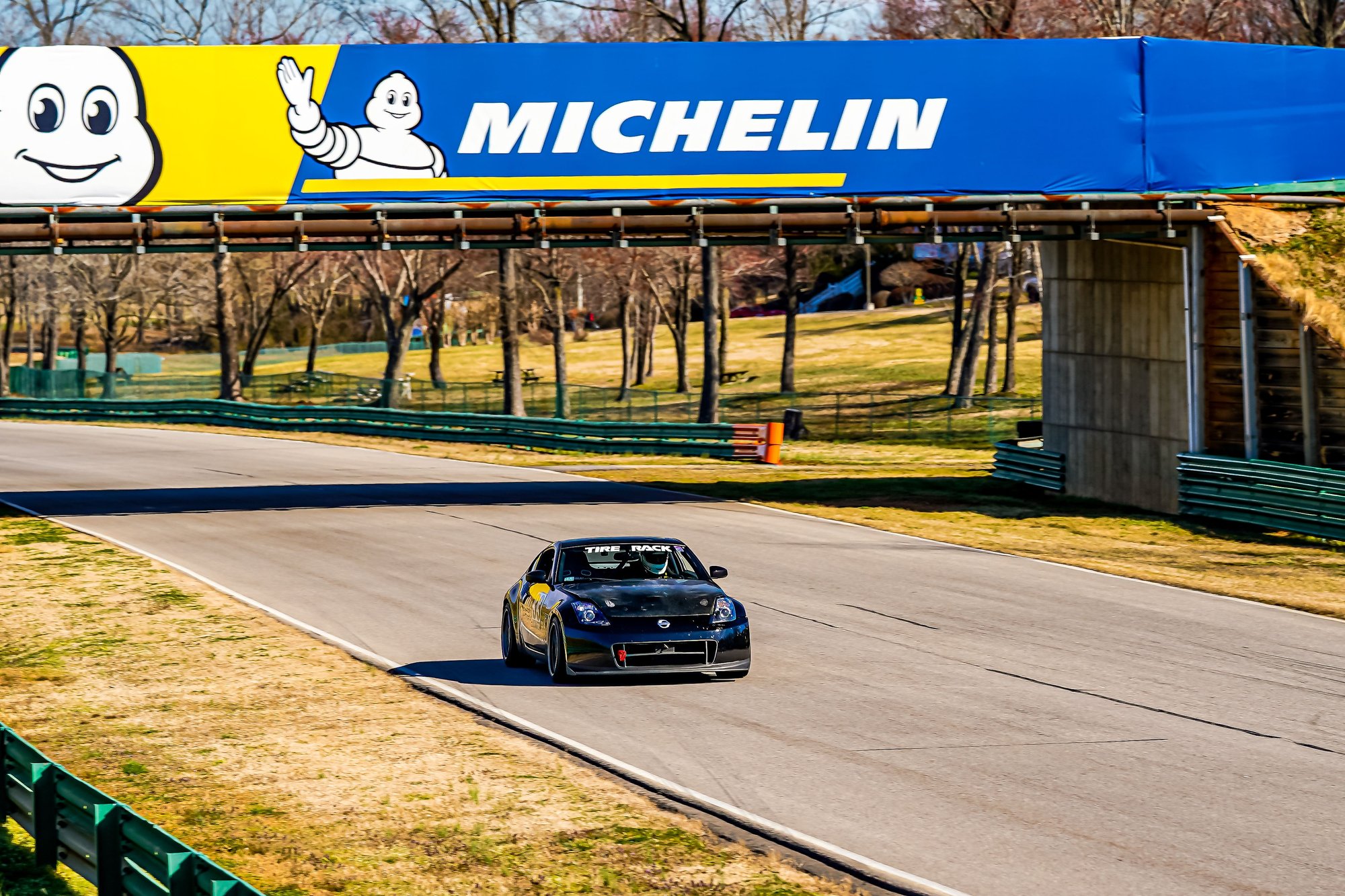

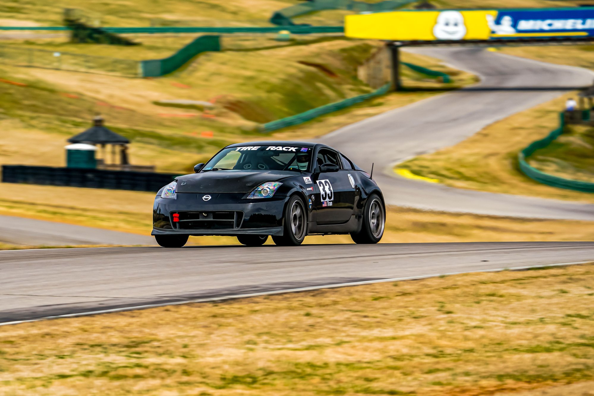

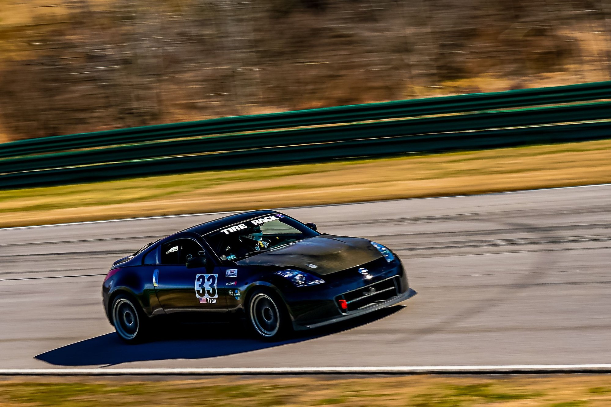

This picture was taken earlier in the year after SCCA TT @ VIR. Love that track! First time there and ended with 2:19.1xx towards the end of the weekend. Super fun track!
Pic taken end of 2020 season with some fellow track Z friends at local HPDE (Thompson Speedway in CT)
VIR random pics
