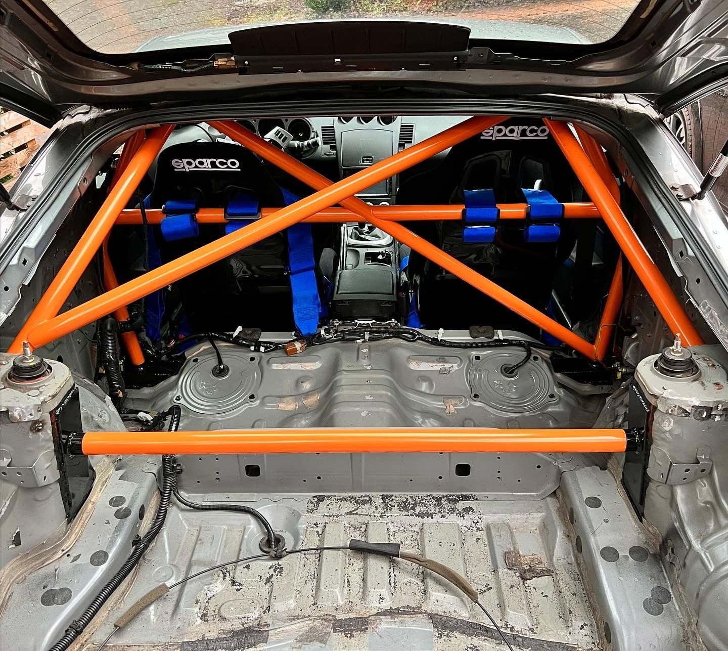

Picked up my Z yesterday from 425 Motorsports after getting the cage and false floor installed. As you can see they created a new, better looking/stronger strut tower brace for the rear.

If you want to have passengers with heads you'll want to get a lower seat mount. I'm 5'11" and I've had students with race seat setups like this and I was not able to fit in their car with the helmet on, had to find a shorter substitute instructor for them. Just FYI, there are better solutions out there.

What do you recommend? I've had 6'+ instructors sit in there with no issue, but always open to suggestions. I've currently got Planted seat brackets and seats on the lowest setting.

Instead of flat plate mounts you'd need either side mount brackets or drop mounts that allow the seat to be mounted below the height of the mount points. Here's an example of such bracket (the one in the back is pass side drop mount)
