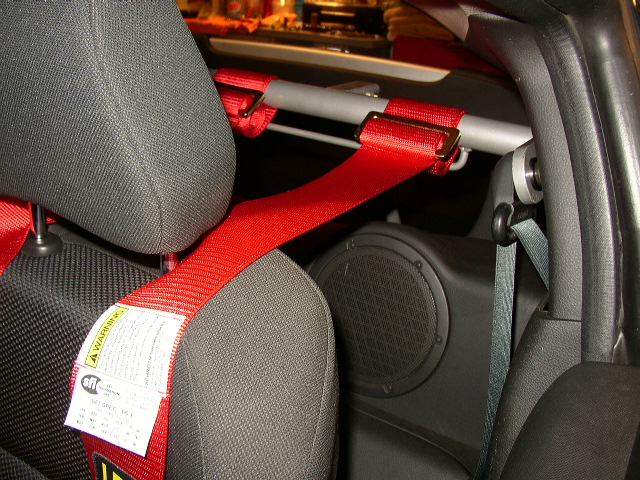

Pic #2:

Okay, someone's go to say it... THIS IS BRILLIANT!
Awesome job EnthuZ!
I'm so amazed at how cool this setup is that I am compelled to know more. Okay, here come the questions:
I'm guessing the the tie rods that you have there are ment to provent the rotation of the main support tube, right? Or is it intended to take a load?
How is the bracket that attaches to the child seat mount mounted?
Is this setup completely bolt -on?
Old Mar 22, 2004 | 09:20 PM
EnthuZ's Avatar
EnthuZ
Posts: 1,965
From: Chicago Burbs
Wow, I thought it was a good idea. Brilliant....
The stays are simply to prevent a twisting load at the B pillars. Not to support the foward crash load.
The lower stay support brackets are simply bolted to the child seat harness bolts. Low load. Just to prevent (probable minimal) bar rotation.
Yes, it is completely bolt in. Simple, no. Minimizing clearances required a bit of "fiddling".

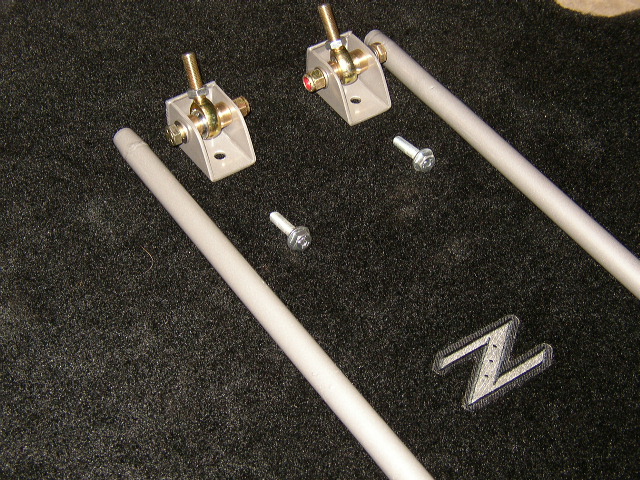

"How is the bracket that attaches to the child seat mount mounted"
With the load path intersecting the center of the bolt head face.

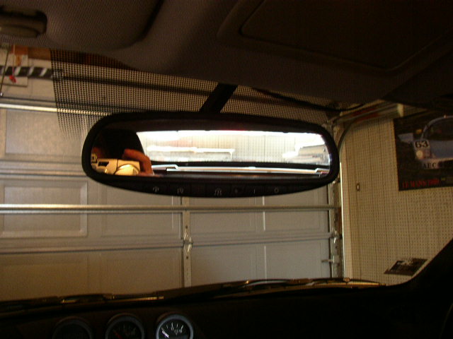

How much does it weight? Can you take a picure of mirror from driver's point of view. Can you take a picture from front and rear of the car to see how noticeble the bar is.
Hom much?
Here is a shot through the rear view mirror. Sorry, you can't see the bar!
