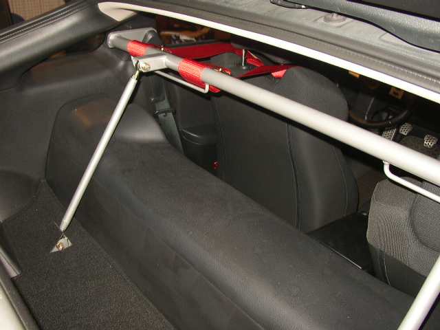

Old Mar 22, 2004 | 07:47 PM
EnthuZ's Avatar
EnthuZ
Posts: 1,965
From: Chicago Burbs
You twisted my arm!
OEM mounting points.
OEM shoulder belt retention.
Approximately 4" increased seat travel.
HPDE approved. By Porsche Club of America.
Pic #1:
