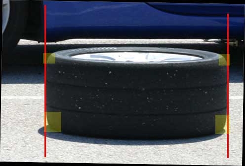

FWIW, I tried doing this to rotate my tires and the wheels don't even fit. I forgot if it was a front or a rear (thinking it was a front, trying to be put on the rear) but the hub center sizing on the wheel was different and it wouldn't go on all the way. For the stock, 17s at least, the wheel wouldn't even fit if you swapped them.
I wonder how much running a 275 on a 7.5" wheel even helps. If you look at this crappy diagram I made to describe what I want to say, look at the inside and outside of the tire.. the tire is so big on the rim it's probably not even on the ground most of the time.
A local Street Mod guy (7th at Nats) was running 225s on a 6" wheel and had a similar situation. He went to an 8" wheel so the tire was damn close to perfectly square and picked up immediate time and PAX points. He said it wasn't even close to being the same - the same size tire setup "square" due to a bigger wheel was so much better than being squeezed on a small wheel.
Not saying the 275s are bad by any means, totally awesome I'm sure. I just wonder if you'd get the same grip level by running a smaller tire on the stock wheel, perhaps a 245 or 255. I have 245 Hoosiers on my stock 17" wheels, they're very square.
My picture isn't totally perfect, but the areas I'm talking about are in yellow.
I think it's pointless to look at unloaded tire. If you want to compare two setups you need to measure contact patch. I never thought about it before but now I think your concerns are reasonable. So measure the contact patch of loaded tire and tell us what it is.
I'm not sure what the best way to do it... I'd try to slowly roll over paper/carbon copy/paper sandwich taped to the bed of sheet metal. It'll give you the width of contact area. Which should be enough. Or jack up the car and lower it on carbon copy (don't forget to seat in it after that), this way you'll get the area in 2 dimentions.
